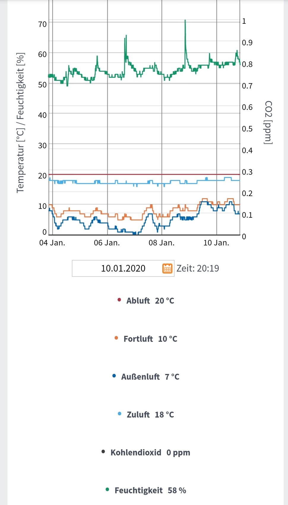

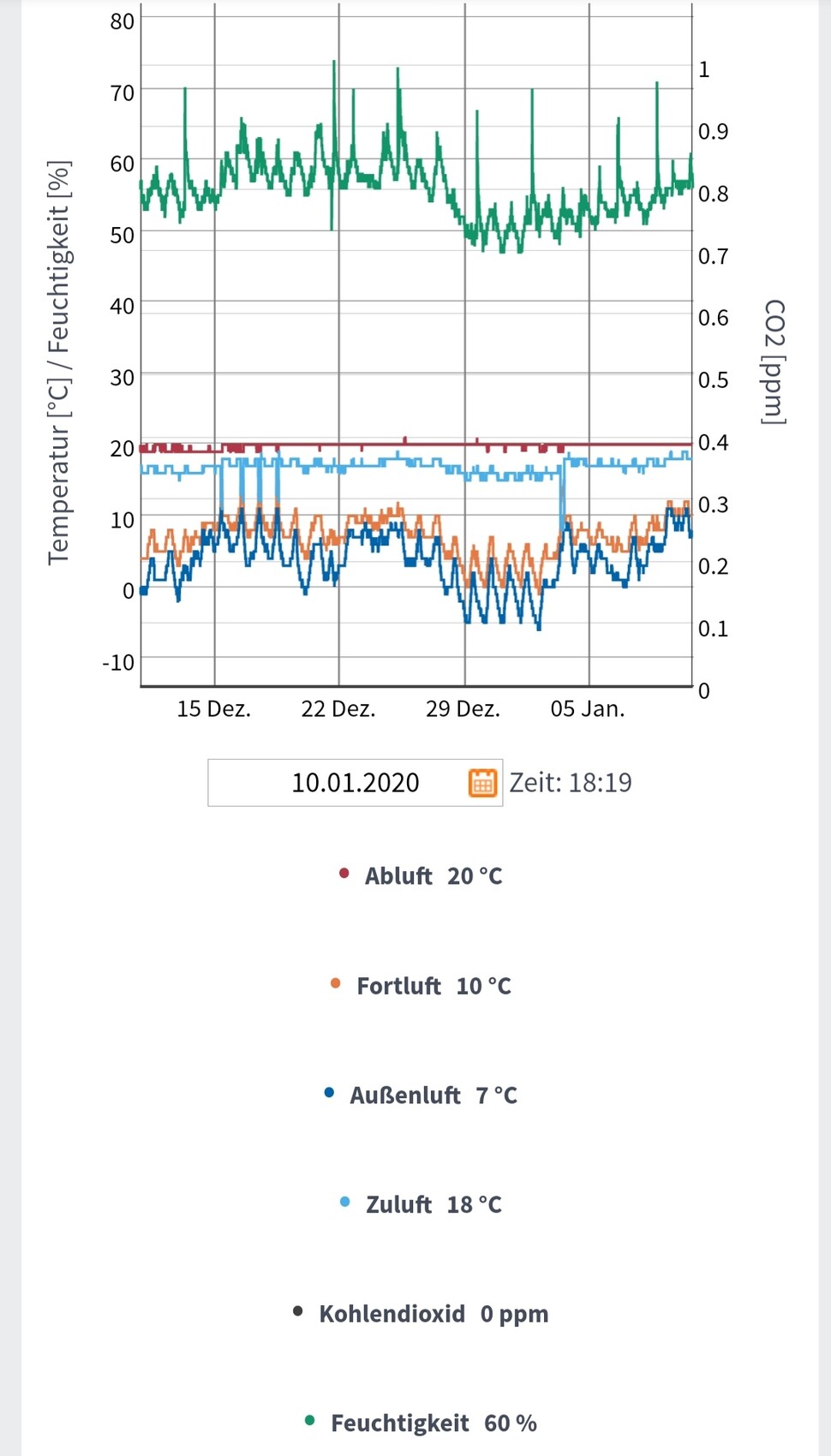

matte1987 schrieb:
We have a Zehnder Q350 with heat recovery and actually struggled with air that was too dry already during the first winter.I can report almost the opposite for us:We built with solid construction (including the interior walls!) and everywhere there is lime plaster with a grain size of 1.2mm (0.05 inches), except for the bathrooms (where there is lime-cement plaster).
We left the lime plaster untreated because of its vapor permeability and based on the plasterer’s recommendation.
The ventilation system is a Vallox ValloPlus 350 MV-E (with an enthalpy heat exchanger).
The system was set up in half a day with air measurements taken at all supply and exhaust outlets by a technician.
The air exchange rate is about 0.3.
After more than a year of operation, we have at least 50% relative humidity in winter and usually between 70–80% in summer.
Therefore, we ordered a regular heat exchanger without enthalpy online and replaced it before winter (November 20, 2019).
Currently, we mostly have between 50–60% relative humidity.
Last winter it was above 60% at this time.
We hope to get below 50% by the end of winter so that we don’t end up at 70–80% again in summer.
According to the architect, this is partly due to the lime plaster, which absorbs moisture and releases it again.
Attached are the current recordings from this week as well as from the month.
(The peaks are mostly from showering)
