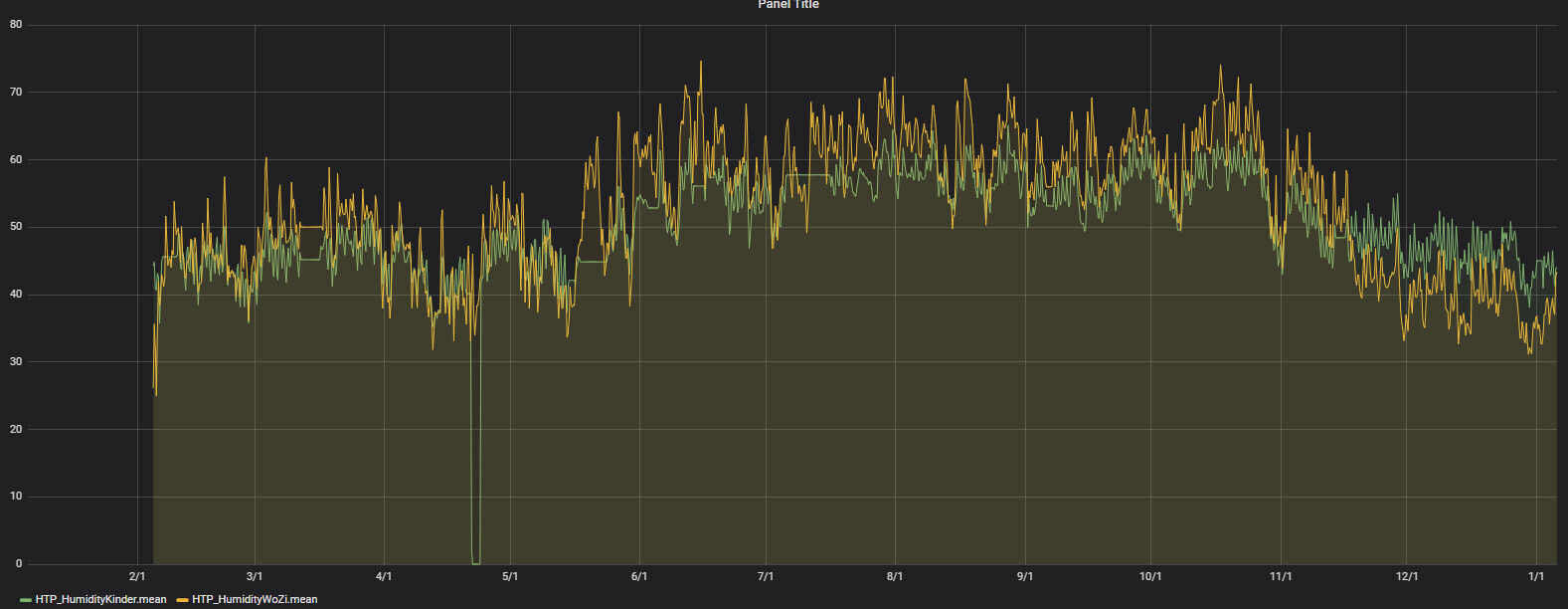

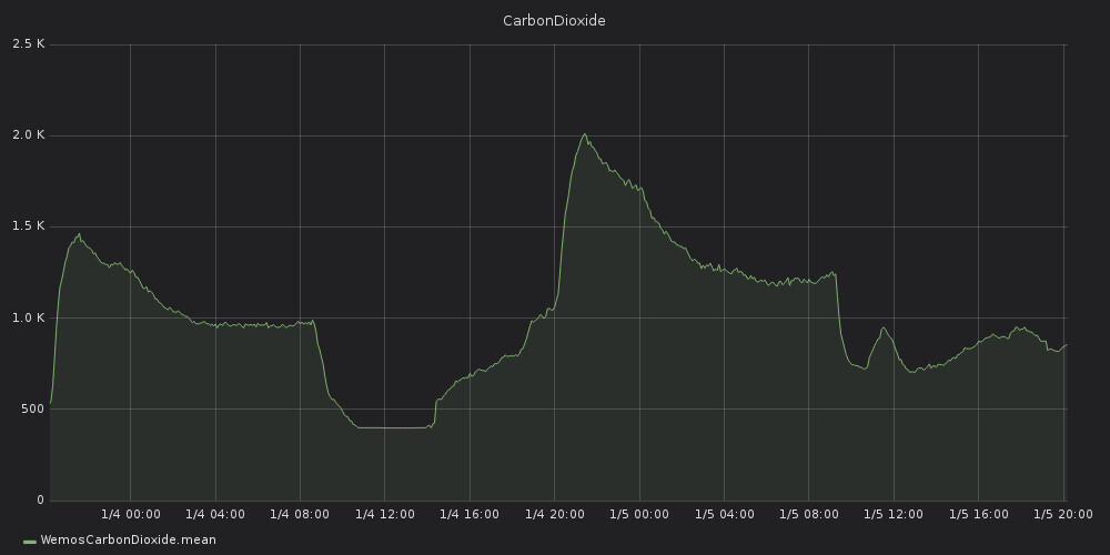

I’ve attached the CO2 levels of the children’s bedroom over the last two days. 400 ppm is outdoor air; usually, the room reaches that level once per day. What’s interesting is the kids’ bedtime with the door closed and three people in the room, followed by the increased fan speed from midnight.
Humidity data for the living room and children’s bedroom over the last 12 months are also attached. Currently, our humidity in the living room is just below 40%. But it will rise again soon and the air quality is still good.
How do you calculate the air exchange rate? Do you have the volume flow rates or air masses in the rooms?
I think that’s quite a lot. I’ve set it so that it averages around 600-800 and ideally doesn’t exceed 1000. That’s not entirely possible in the bedroom, where it sometimes goes higher at night. Due to the issue mentioned above, this results in having 1000 ppm at 3 a.m. in the bedroom where you’re lying down, while the entire ground floor, where nobody is, measures 400 ppm.
If it were possible to reduce ventilation in living areas at night and in the bedroom during the day, average air exchange rates of 0.2-0.3 would probably be sufficient. However, that would mean reaching 4000 ppm in the bedroom at night, and an average of 700 at the system level is well within the safe range.
