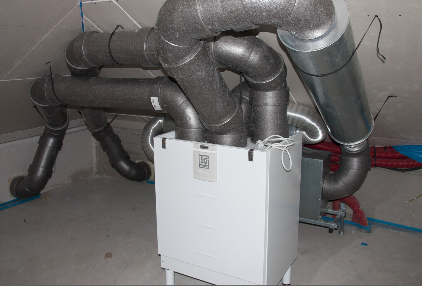

nordanney22 Jan 2021 14:19During the shell construction phase, we marked and labeled the spaces on the wall for electrical connections, washing machine/laundry dryer, heating, and freezer with chalk. Now, everything is installed. The dimensions are listed in the datasheet, and you should already check whether the utility room is large enough and has sufficient wall space.
The unit is about the size of a refrigerator – that’s how it was advertised to us.
It is actually no larger but is mounted on the wall. The ceiling appears as shown above, with pipes.
The mechanical ventilation system can also be installed in a more space-saving way by mounting it on the ceiling; it basically makes no difference. This is even recommended if the ceiling height is increased.
