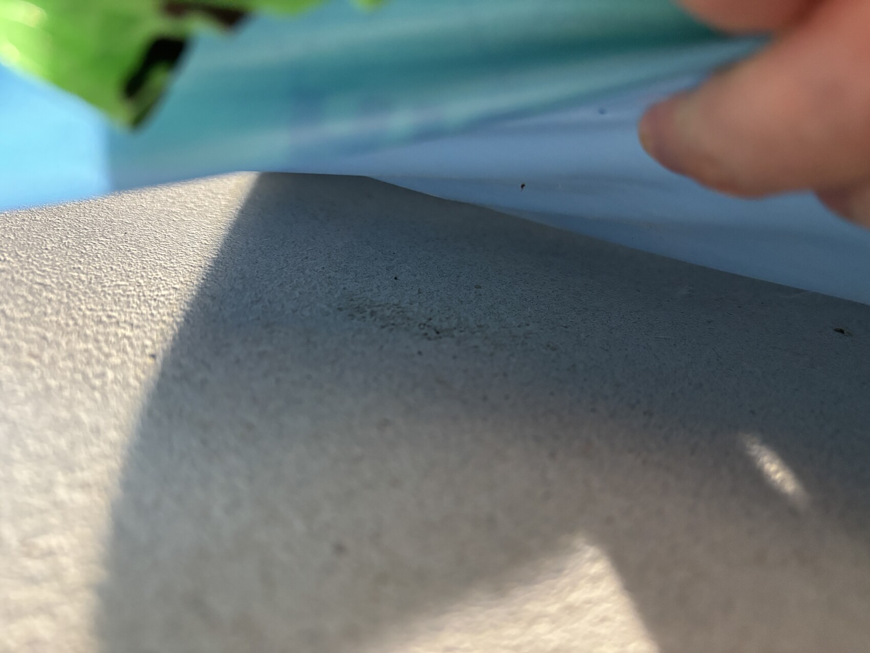

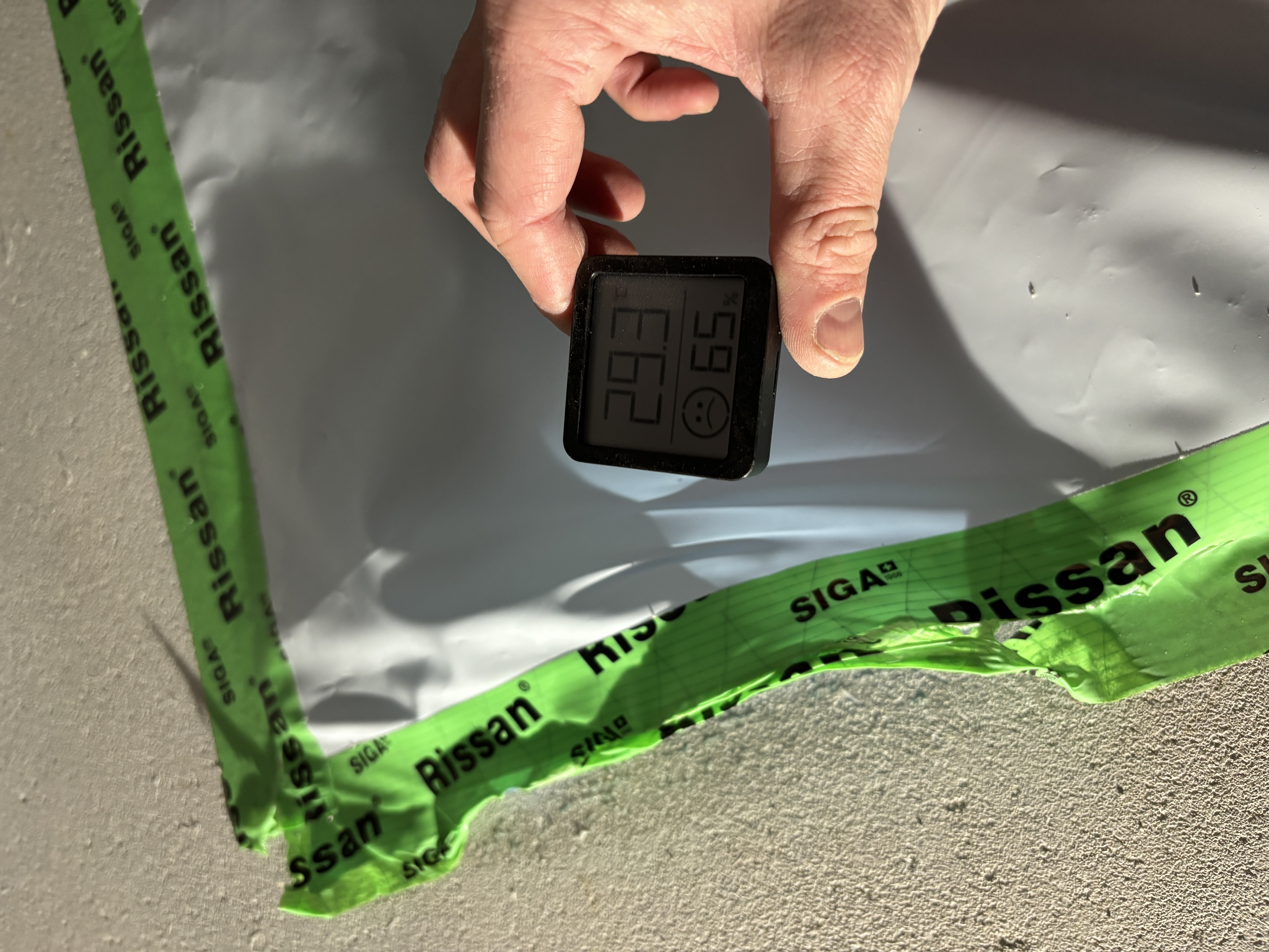

After 24 hours open: still dry and humidity below 65%. The spot is one meter (3 feet) away from today’s measurement point, which showed 2.2% CM (calcium chloride moisture content). I closed the spot again and now have the room window tilted open, while the heat pump is running again. Let’s see how it looks tomorrow.
