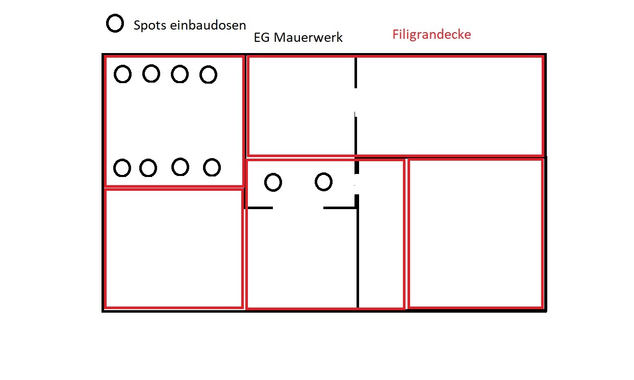

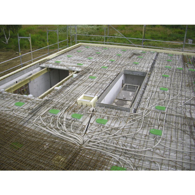

Was the drilling included in the 100€? I can’t say how your house will be built. Nowadays, there are hundreds of different construction methods. Our ground floor was built with solid masonry. On top of that, a prefabricated concrete slab made of several sections was installed. Reinforcement steel was then placed inside and finally embedded in concrete. The finished floor buildup with insulation, screed, upper floor walls, etc., goes on top of that.
The prefabricated concrete slab is cast at the manufacturer’s facility and delivered in several parts, as mentioned. Now imagine the recessed light housing like a 5kg (11lb) yogurt cup. This cup is simply installed at the factory and embedded in the concrete. When the slab is delivered to the site, you also need to be there to pull your wiring through the housings. There is a lid that you can open to pull the cables through. Afterwards, the cable plus the complete housing are embedded in concrete.
The housing has a diameter of about 15–30cm (6–12 inches), depending on the manufacturer. The actual spotlight only requires about 6–7cm (2.5–3 inches). So even if the housings aren’t installed perfectly level, you still have some leeway and will need to measure precisely later anyway. The walls will also be plastered with varying thicknesses, so you can’t calculate this exactly beforehand; hence the large "yogurt cup."
You therefore need to get these housings and a floor plan of your house and mark where the housings should be located.
Unfortunately, I don’t have a photo of our ceiling on hand right now, so I attached one from the internet. But our ceiling looked very similar. I also tried to sketch the ceiling buildup for you using Paint.
Why the long explanation?

danixf schrieb:
I can’t say exactly how your house will be built. Nowadays, there are hundreds of different methods. Our ground floor was built with solid masonry. On top of that came a precast concrete ceiling made from several elements. Reinforcement steel was then placed inside and the whole thing was finally cast with concrete. On top of this goes the actual floor structure with insulation, screed, upper floor walls, etc.
The precast ceiling is cast at the factory by the ceiling supplier and, as mentioned, delivered in several parts. Now, imagine this recessed light box like a 5kg (11 lb) yogurt cup. This cup is simply inserted at the factory and cast into the concrete. When the ceiling is delivered, someone needs to be on site to pull the cables through these boxes. There is a cover that can be opened to pull the cables through. Afterwards, the cables plus the entire box are encased in concrete.
The box has a diameter of about 15–30cm (6–12 inches), depending on the manufacturer. The recessed light itself only needs about 6–7cm (2.5–3 inches). So, if the mounting boxes are not installed perfectly straight, there is still some room for adjustment and you will have to measure precisely later anyway. The walls will also be plastered with varying thickness, so you can’t calculate everything exactly beforehand—that’s why the “yogurt cup” is so large.
You need to get these boxes and a floor plan of your house, and then mark exactly where the boxes should be located.
Unfortunately, I don’t have a photo of our ceiling at hand right now, so I added one from the internet. But our ceiling looked very similar. I also tried to draw the ceiling structure with Paint for you.
