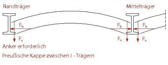

I would like to know if it is possible to break through a hollow-core slab ceiling to install a staircase. The plan states that the ceiling is a Keiser Katzenberger slab, similar to the one in the picture. I have no experience with renovations, but I would assume that as long as the beams are removed and the width corresponds to the spacing between beams multiplied by x, it should be possible.

Prussian cap between edge and middle beams; horizontal and vertical forces.

The plan states that the ceiling is a Keiser Katzenberger ceiling, similar to the one in the picture.
However, the picture shows a beam-and-block ceiling. What is actually the case? – In principle, your project shouldn’t be complicated, but on the other hand, it’s not something to be done “by two guys and a hammer.” Architects do not only design entire houses but are also recommended to be consulted for projects like this.

The ceiling is a beam-and-block ceiling, but on the plan it says "kaiser katzenberger ceiling"... whatever that means. Of course, I wouldn't do it myself; I just wanted to know if it’s possible and not extremely complicated...

Feasible, yes. Possibly with beams, as with wooden joists. Nothing more can be said at this speculative stage without visual references.
