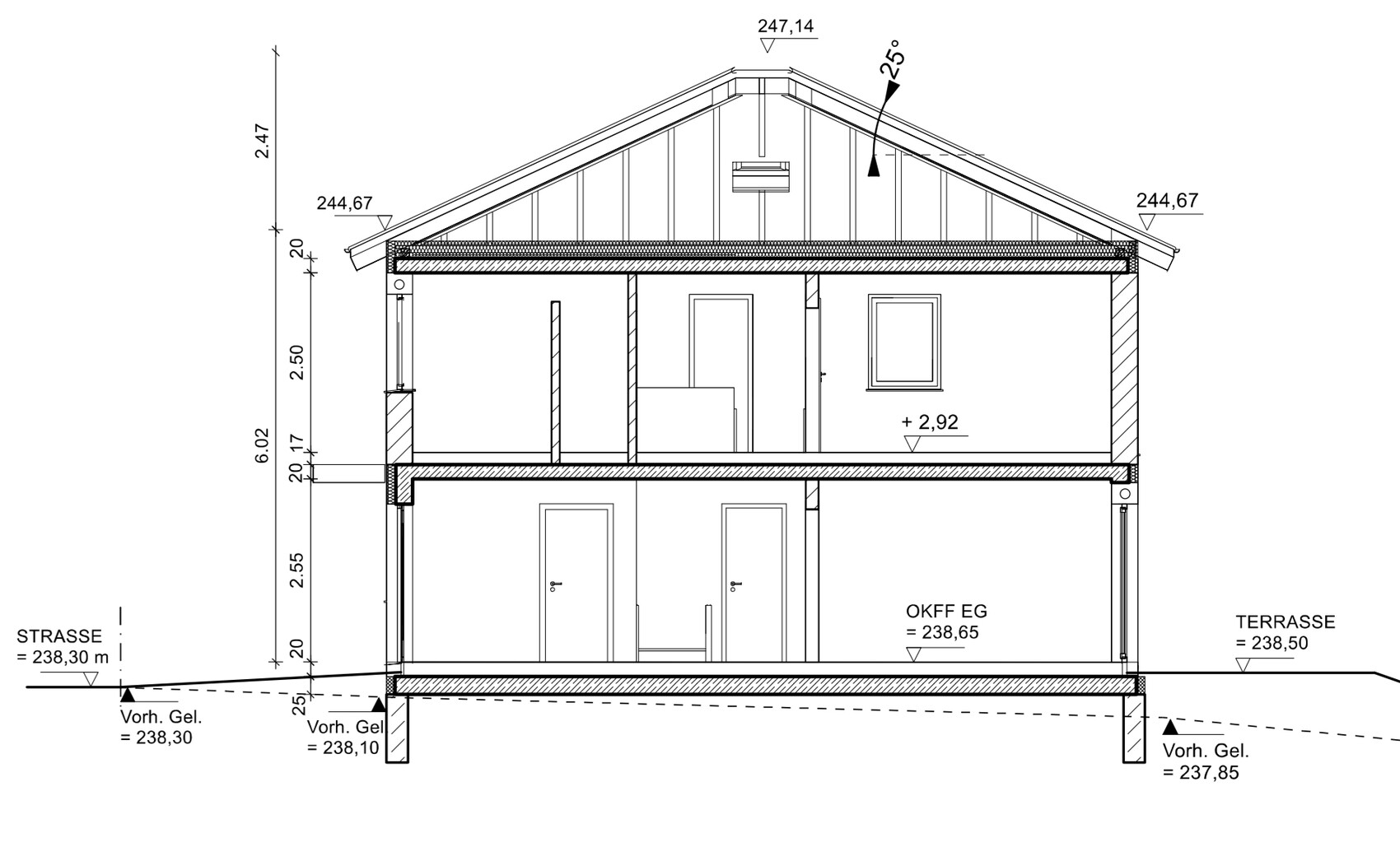

We planned for 2.55 m (8 ft 4 in) on the ground floor and 2.5 m (8 ft 2 in) on the upper floor (height measured after floor structure).

How do you arrive at the 2.55 m (8 ft 4 in)? What is the rough structural height of your ceilings?
Regards,
Sabine From the cross-section drawing.
Did I miss something there?
I hope that after installing the central controlled residential ventilation system and completing the plasterwork, the 2.55 m (8 ft 4 in) will still be available on the ground floor.
