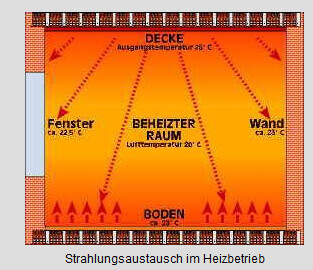

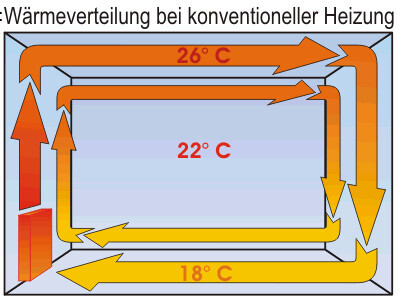

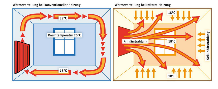

Exactly regarding radiant heat, I found some images to illustrate it, but unfortunately I haven’t experienced it live yet. I only know radiant heat from spa facilities in sauna areas, where it is very pleasant.
