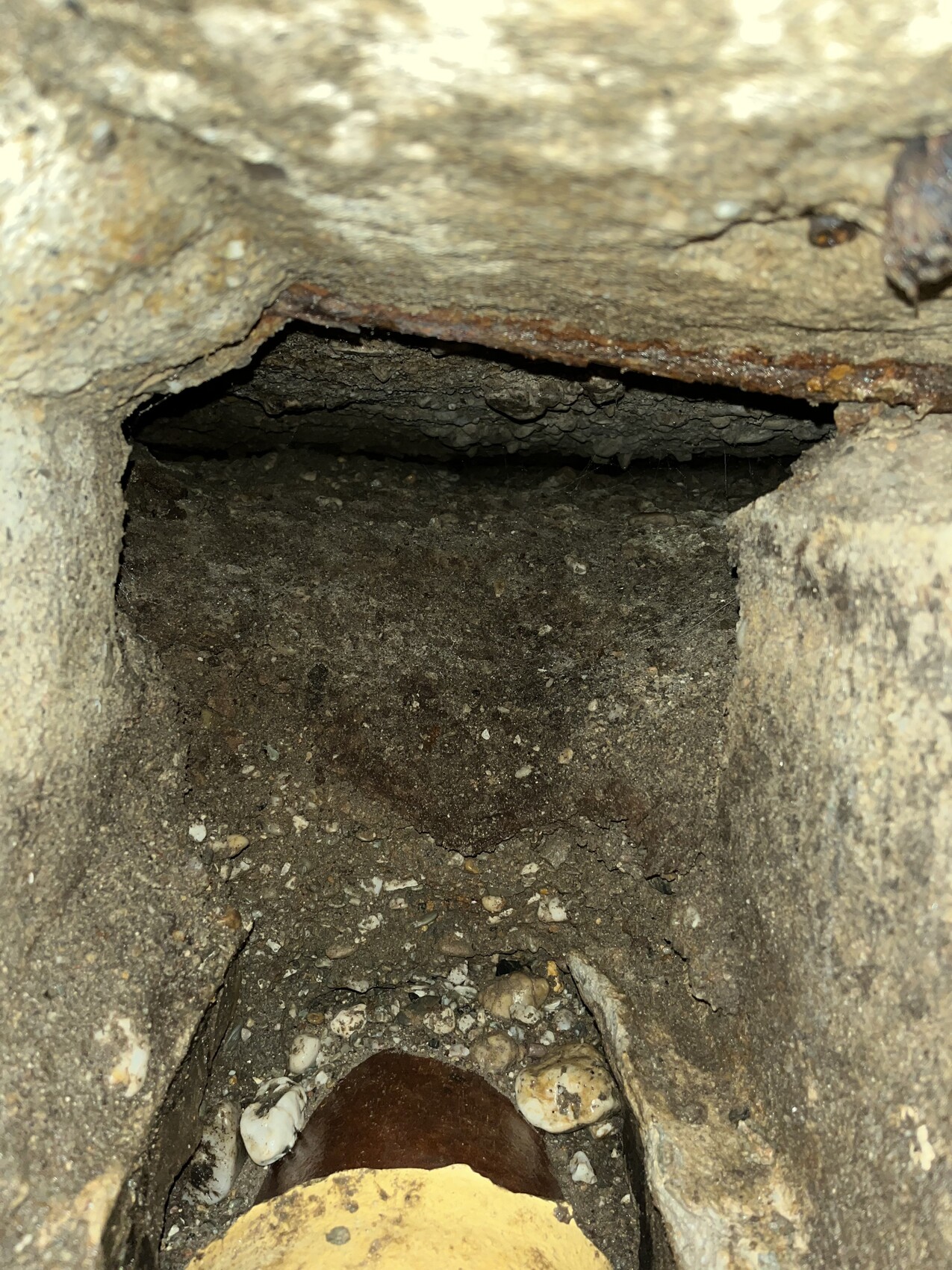

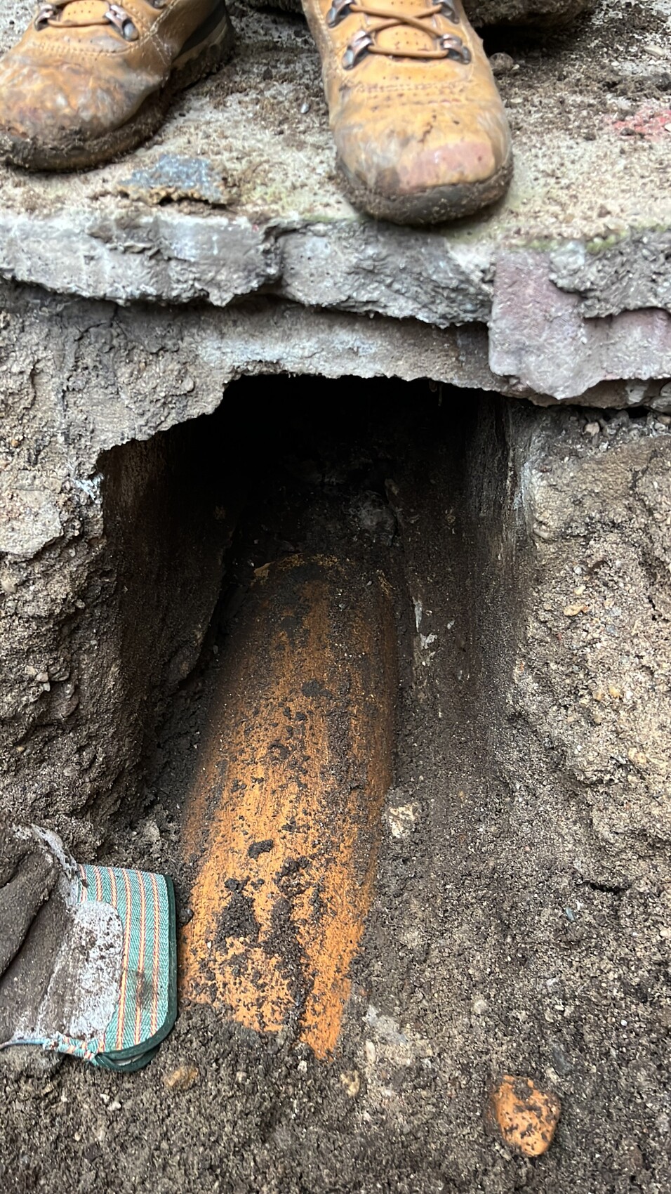

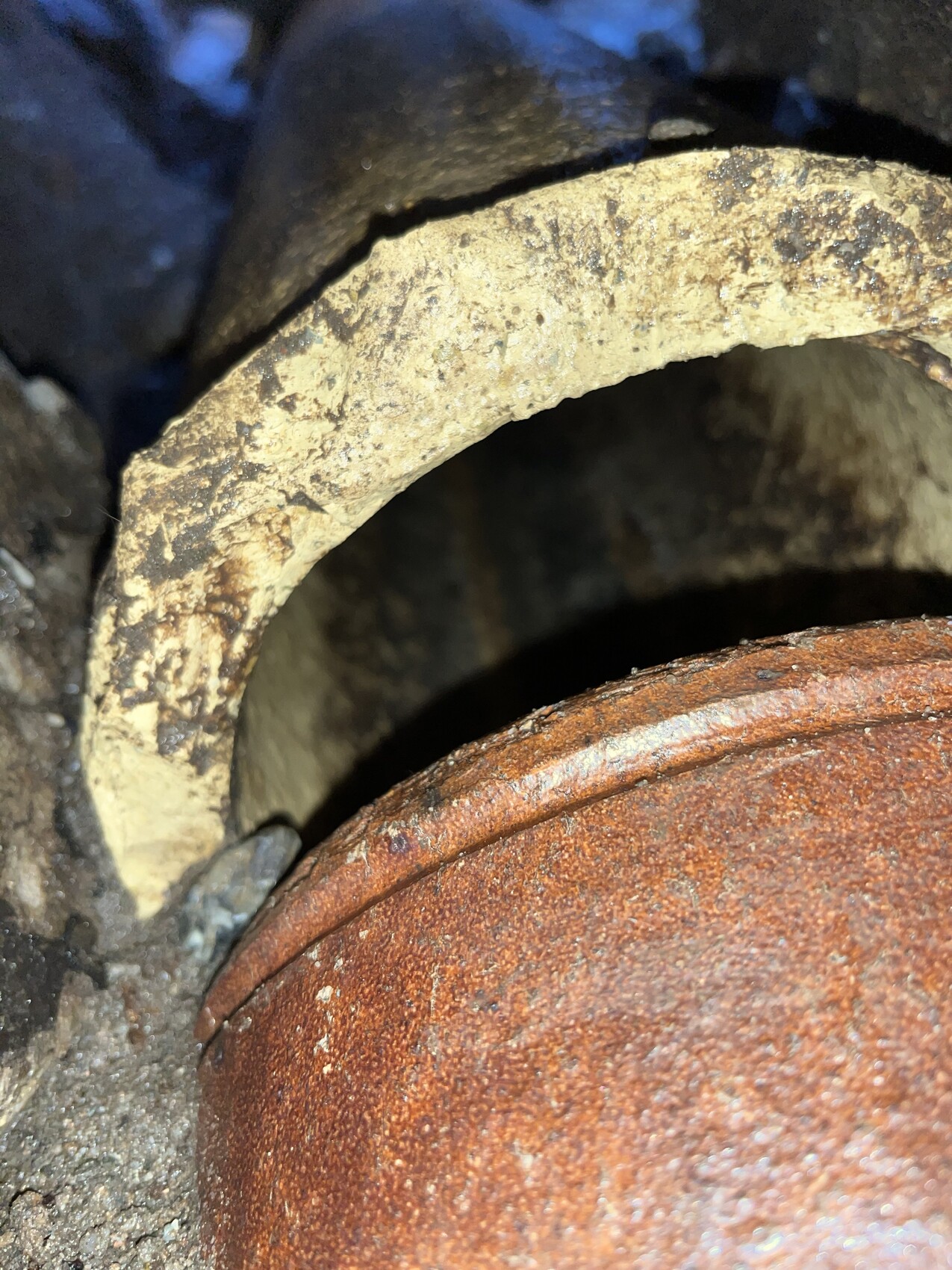

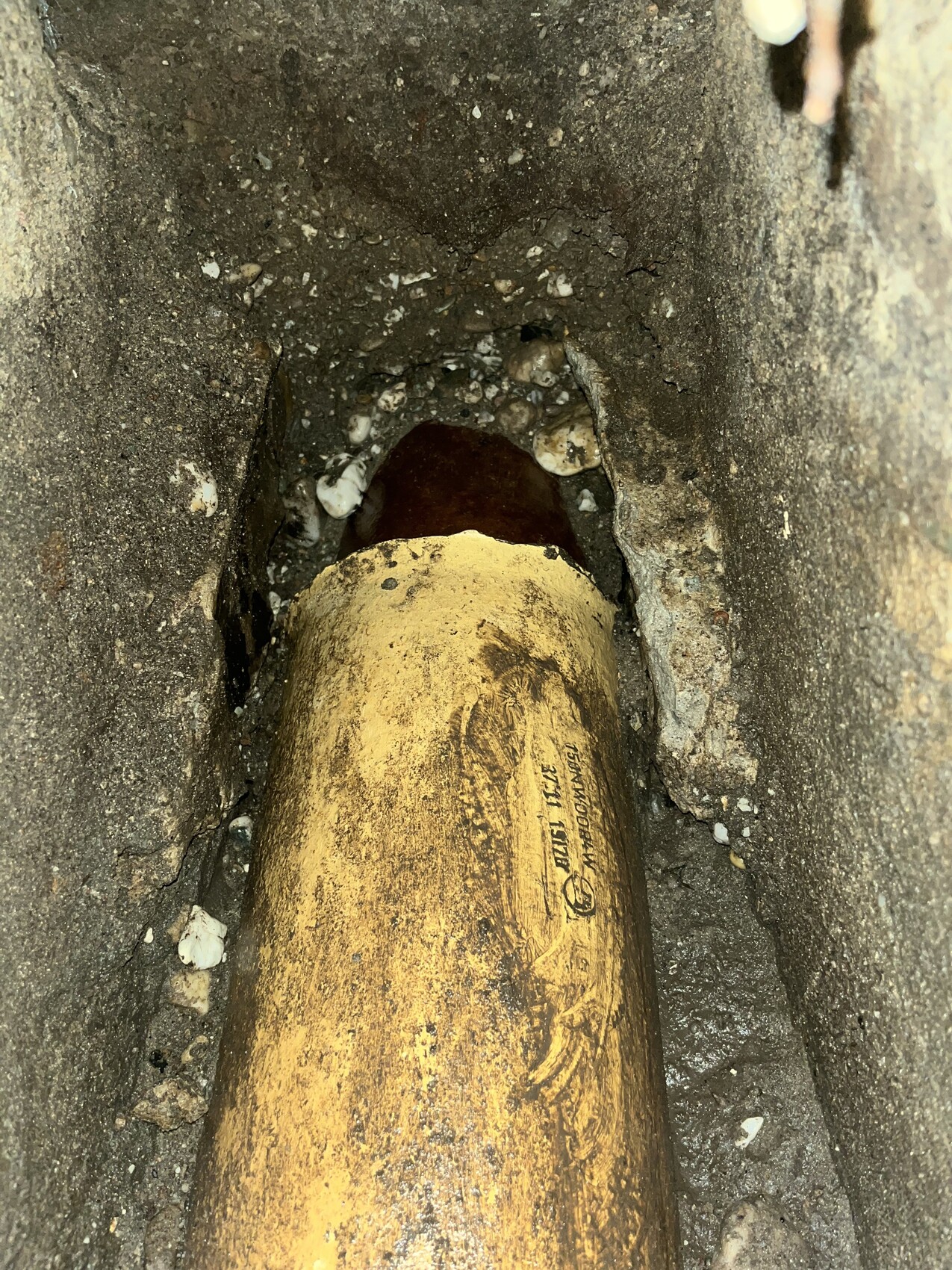

Altmark19808 Mar 2023 21:33Good evening,
House built in 1980.
Basement with driveway and parking space. Basement is below street level.
A camera inspection of the wastewater pipe (ceramic pipe running diagonally under the house) showed that it has settled. One pipe section was sloping slightly upwards in the direction of flow.
Today, I dug from the outside down to the strip foundation and saw that there is a large cavity between the pipe and the basement floor (15cm thick (6 inches), no foundation).
At some point, the pipes outside were replaced, but the connection to the pipe under the house was not done professionally. (The pipes were just laid end to end without a sealing ring.)
This leak has further contributed to the ground settling.
What do you suggest? Should the cavity be compacted and sealed?
If yes, how?
Have a nice evening
If yes, how?
Have a nice evening

Altmark198013 Mar 2023 19:33Marvinius schrieb:
Seriously: Please discuss the issue with a qualified civil engineering company.Thank you for the advice, not just trying to reach the minimum number of characters.Altmark1980 schrieb:
This leak further contributed to the ground settling.Recently, there was a series of reports in the press (I believe it was Spiegel) showing where large underground cavities have formed and collapsed around the world. Underground water movements are not to be underestimated...
I have no idea what exactly needs to be done, but I think it makes sense to closely monitor the situation and take appropriate action.
Altmark198014 Mar 2023 11:49Nida35a schrieb:
Waste pipes must be watertight.
In my opinion, everything needs to be removed and replaced.
These soakaway pipes are prohibited, and you’re lucky that the utility provider hasn’t required you to take action yet. Which soakaway pipes do you mean? I don’t quite follow you. The ones shown have no soakaway holes.
If you mean the stoneware pipes, then many homeowners would now have to start removing their front yards and floor slabs.
And if we didn’t care, we wouldn’t be paying attention to it.
