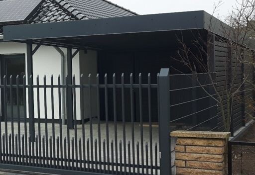

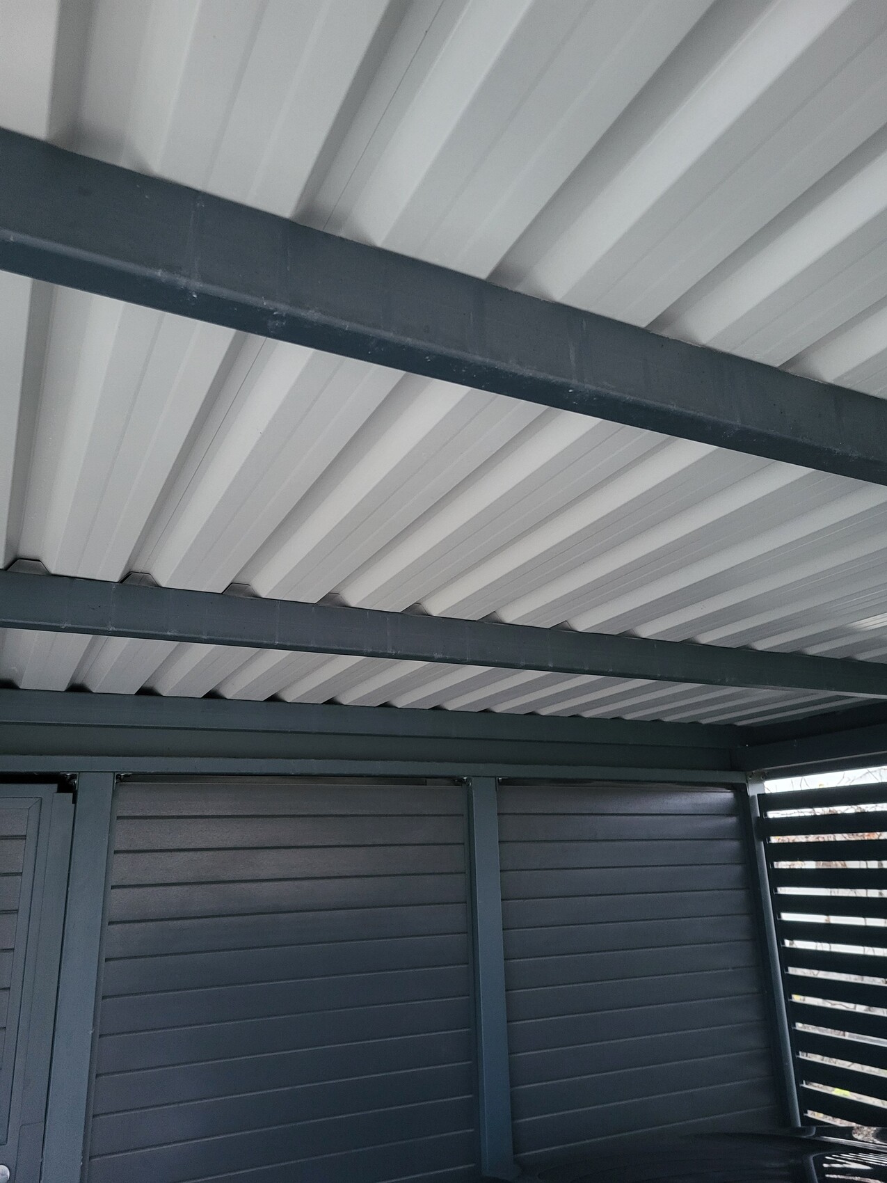

Hi,
I have the following problem:
My carport is made of aluminum panels with a metal roof.
When it gets colder outside, and the sun shines on the roof, the inside of the roof starts to drip.
Not the inside roof surface itself, but the crossbeams.
What options are there to cover these beams so they don’t constantly leave these "unsightly" water drops on my car?
The carport is well ventilated and covered on one side with a "permeable" cladding.
Covered terrace with white metal roof and dark steel beams
tomtom7920 Nov 2025 15:03
Are all sides probably closed or at least nearly closed?
Mahri2320 Nov 2025 16:07
No. Only the right "north side" is somewhat enclosed, but not completely. The west side is closed off by the adjoining room.

Mahri2321 Nov 2025 11:47
I have now ordered a few pieces of this fleece.
When the weather outside becomes more pleasant again, I might install them then....
