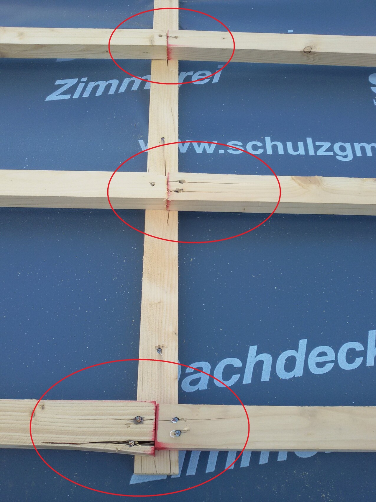

1. Some slats are split at the headboard.

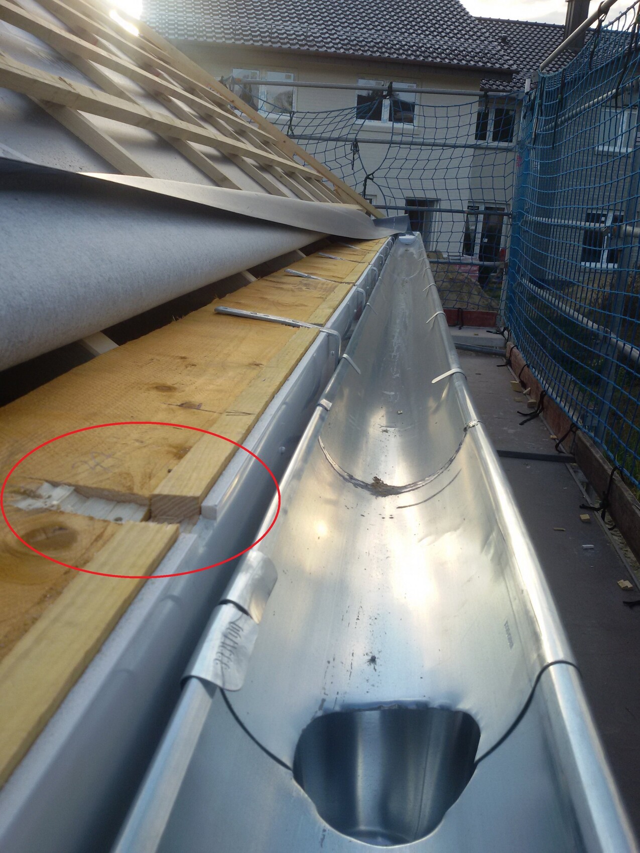

2. The attachment of the gutter in the designated position is without fastening.

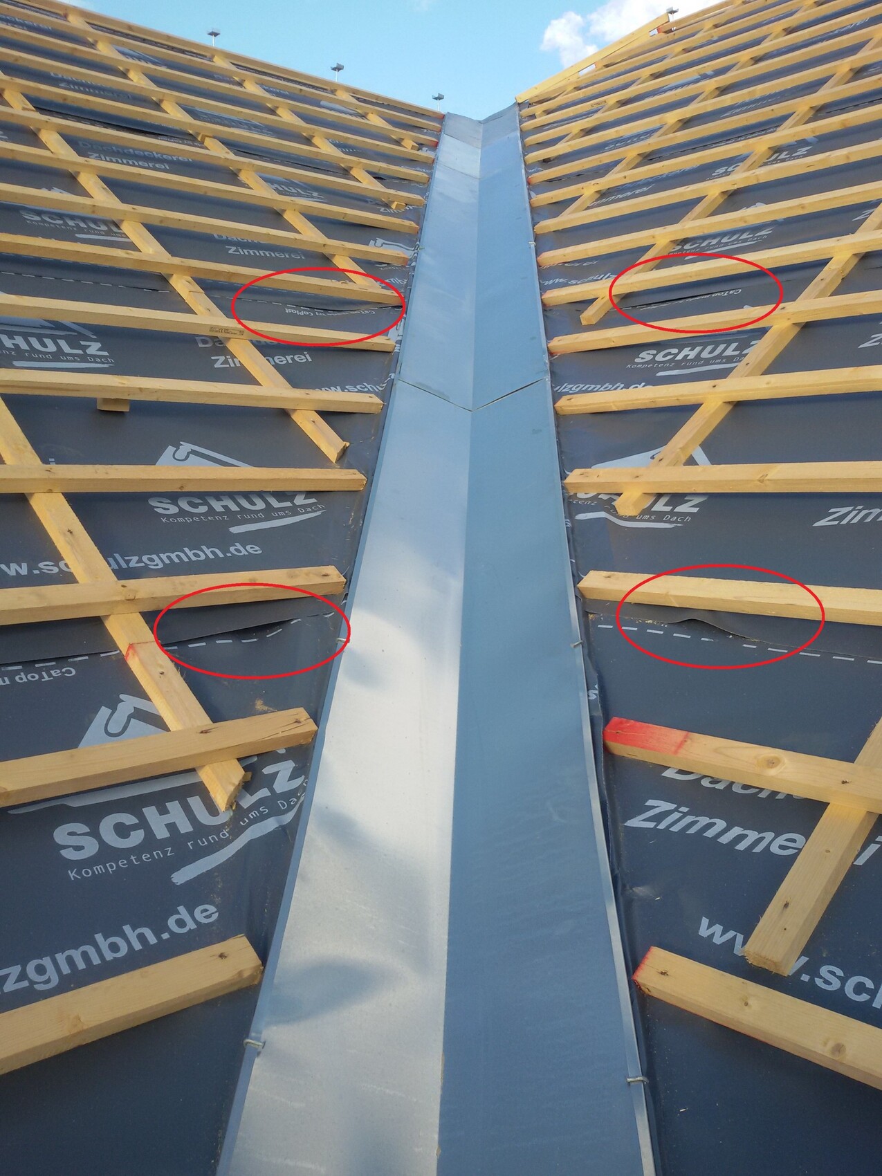

3. The underlay membranes are not glued.
4. Battens and ventilation grilles are missing at the edges.

Here are a few photos...

16 Oct 2018 09:24
No, not all slats.
