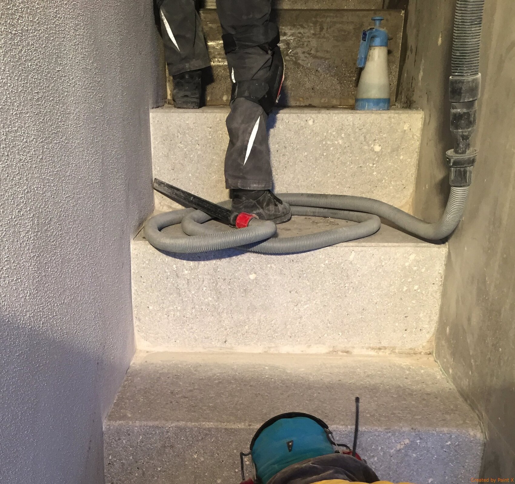

There are many things you can do with concrete afterwards. You can acid wash, grind, polish, sandblast, expose aggregate, and more. Search for “betonsuisse” here for a great overview. Of course, depending on the surface, it will be more or less susceptible to these treatments.
We also have a fair-faced concrete staircase that was cast on site. Compared to precast concrete stairs made in a factory, it’s almost impossible to achieve an acceptable surface quality on site. That’s why the staircase was recently ground by a specialist company, and small holes were filled with a special filler.
Afterwards, the concrete (like all other fair-faced concrete surfaces) is sealed. This can easily be done yourself and does not change the appearance of the surface.
You can also search for “Hebau” on this topic, for example.
I’ve attached a photo showing how the staircase looked this evening after grinding.
Regards
