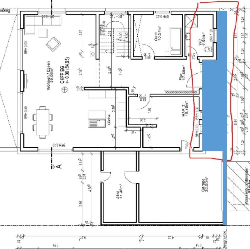

I am looking for some constructive solutions for a canopy at the entrance area.
On the right side, we have a small bay window that projects about 1.20m (4 feet) out, then the entrance area, and then the garage, which is roughly at the same level as the bay window.
The gap between the bay window and the garage (about 6 meters (20 feet)) should be covered, as shown in the example photo.
I am now searching for suggestions on how to construct this canopy between the bay window and the garage.
Thanks in advance for your help.

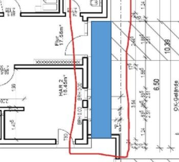

Ground floor plan of a single-family house with living/dining area, kitchen, hallway, bathroom, WC, garage; red outline.
Ground floor plan (area marked in red shows where the canopy should be)

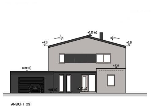

East view: two-story house with garage on the left, window front and entrance, pitched roof.
Front view
hanghaus2000
2 Jul 2021 09:58

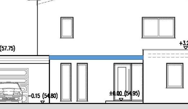

The canopy as planned. See attachment:
2D floor plan with blue wall marking and red outline of a hallway area
Front view of a two-story house with garage on the left, door and window, blue beam
KonstantinW
2 Jul 2021 11:18

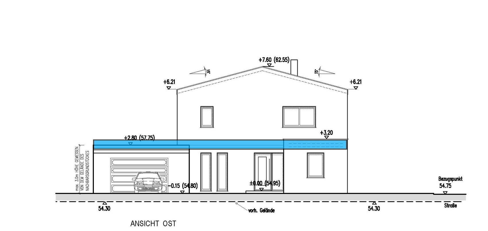

Preferably designed so that no transitions are "visible."
East view of a two-story house with a garage on the left, windows and a blue band.
hanghaus2000
2 Jul 2021 13:09

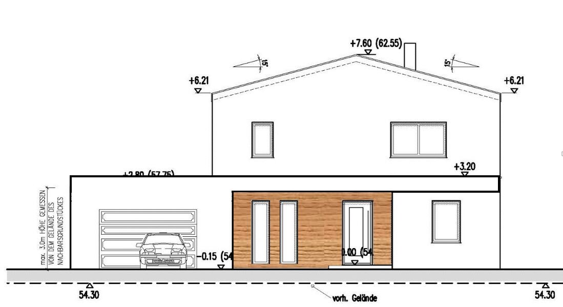

If so, then like this. Raise the front wall of the garage.
Floor plan of a house with living room, kitchen, hallway; blue beam on the right, red border marked.
Modern two-story house with wood cladding on the main building and garage on the left.
Alternatively, use a different color for the garage and the porch roof.
KonstantinW
2 Jul 2021 13:59
[ATTACH alt="ueberdachung-hauseingang-wie-ausfuehren-508256-2.JPG"]63284[/ATTACH]
Alternatively, the garage and canopy in a different color
What about the garage height? As far as I know, it may be a maximum of 3 meters (10 feet) high?

hanghaus2000
2 Jul 2021 14:42
The height of the garage will remain 3 meters (10 feet). Only the front wall will be slightly higher. If you have any concerns, check with the building authority / planning office to see if that is allowed.
When I look at the design, my first suggestion doesn’t seem so bad after all. Widen it to 1.5 meters (5 feet), and then it would be perfect.
It would be better if the garage were placed slightly further back and a continuous roof planned to extend in front of the garage as well.
