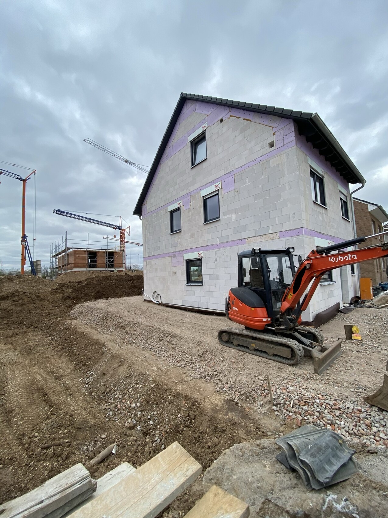

goalkeeper20 Apr 2020 15:04Reini1234 schrieb:
@goalkeeper
How did the situation end up? I have the same question.We partially filled it with material that a neighbor dug out next to the site and then compacted it with gravel.
In the picture, the final width had not yet been completed.
