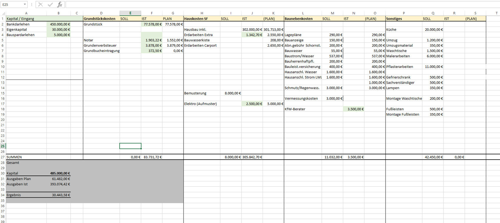

I can upload my Excel file as an example. Basically, every building project is unique, so the cost items will vary individually as well. I recommend creating an Excel sheet for your personal project and gradually refining it step by step. My planning is for northern Germany/near the coast with peaty soils, so load-bearing capacity is more of an issue here than slopes or rock—so make sure to do some specific research on your foundation costs.
Edit: The numbers in the screenshot are just examples. 🙂
What’s missing from my calculation is a budget for landscaping and external works. I would advise including that if you still have some buffer.
The groundworks and carport are not included in my calculation since they are covered in the house price. If you plan not to build turnkey, I suggest planning each trade separately on an extra Excel sheet and referencing those totals on the main overview sheet.
