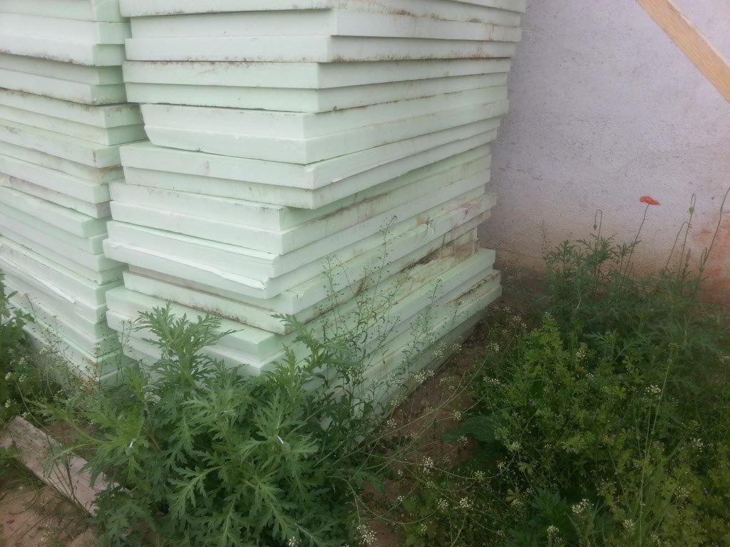

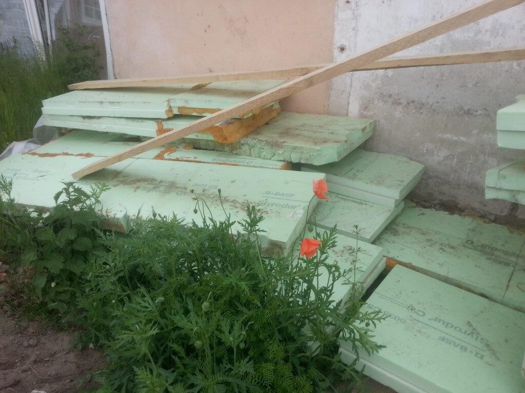

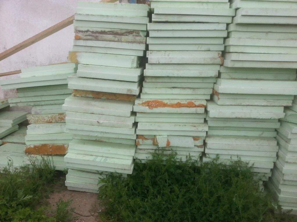

Today, to our surprise, we discovered a large pile of used extruded polystyrene (XPS) insulation boards on our property. I’m a bit puzzled… I assume these are intended for the foundation insulation. It looks somewhat like they might be from a building demolition. Is it acceptable to reuse them like this? Some of the boards are quite damaged… On the other hand, if they fully serve their purpose, it would also prevent new production because of us.

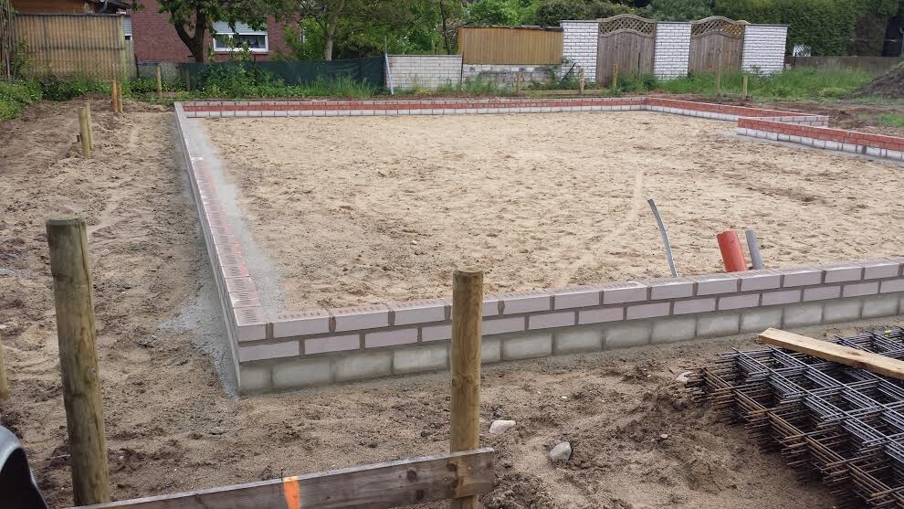

Called a structural engineer, who said that using steel fiber concrete is fine and even tends to be of higher quality. This is not a foundation but the frost protection strip.
The building inspector is not reachable.
Today, a ring beam was built on the strip. The mentioned slabs are to be placed on this ring beam.

Just talked to the builder – he said that if the panels cause us too much trouble, he would replace them with new ones.
Also had a brief conversation with the mason who covered the entire surface with waterproof slurry – that sounded reasonable as well.

These panels are not mine. Some were used for the perimeter insulation (between the foundation slab and the brickwork), and some were picked up.
The base has now also been coated with bitumen; everything looks fine so far.
