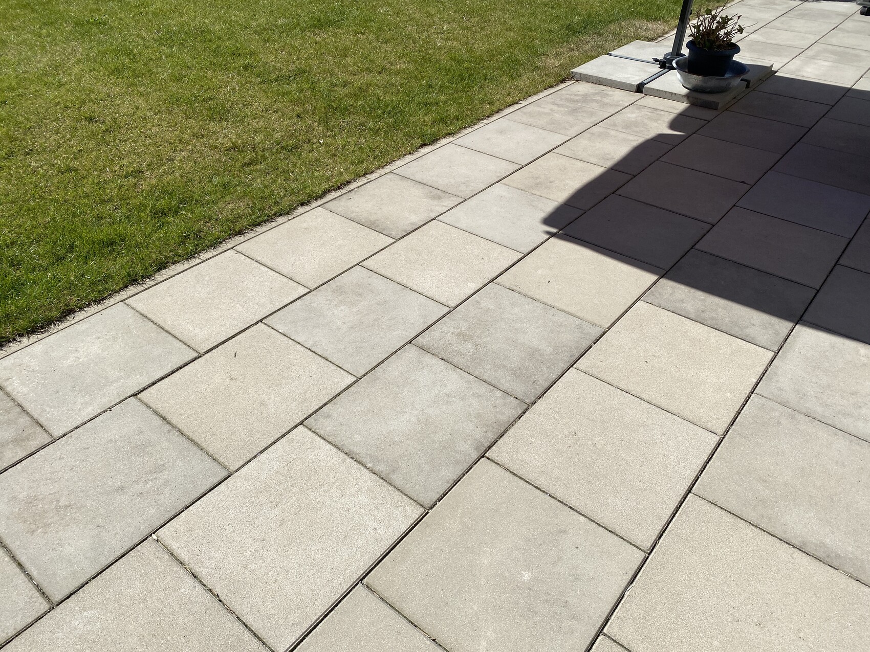

In 2017, we moved into our newly built house. The purchase price included a typical concrete slab terrace (see photo).
Size 4 x 9 m (13 x 30 ft) plus a corner section leading to the garage (approximately 5 m² (54 ft²)).

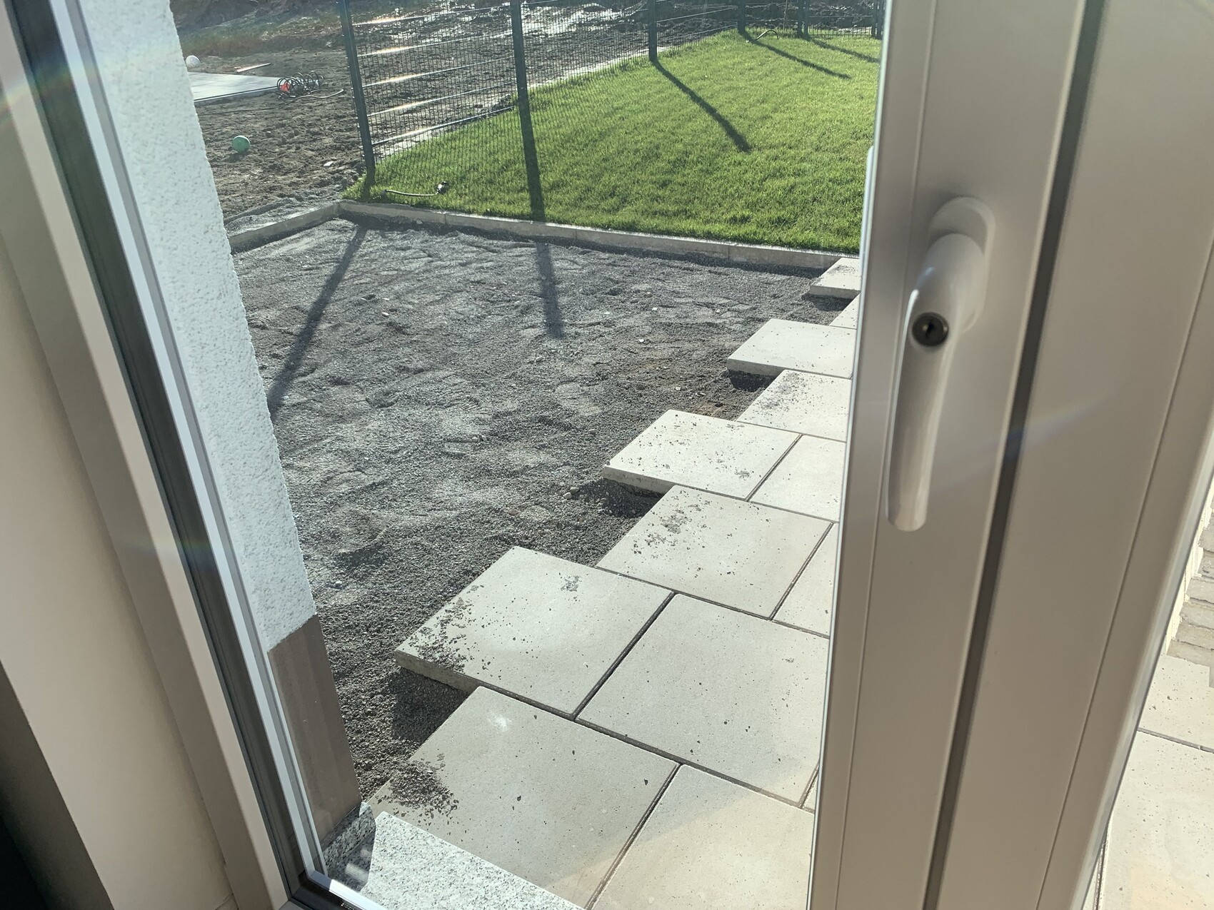

The slabs were laid on a gravel bed (see photo from “back then”).
Since we already have a high step into the house (about 19 cm (7.5 inches)) and now want to enhance the terrace with polygonal stone slabs in a Mediterranean style, we are wondering if we can use the existing concrete slabs as a base? The slope is already ideal, and our thought was that the concrete slabs provide a solid foundation for our project.
Is this feasible, and is there anything special we need to consider given our situation?
