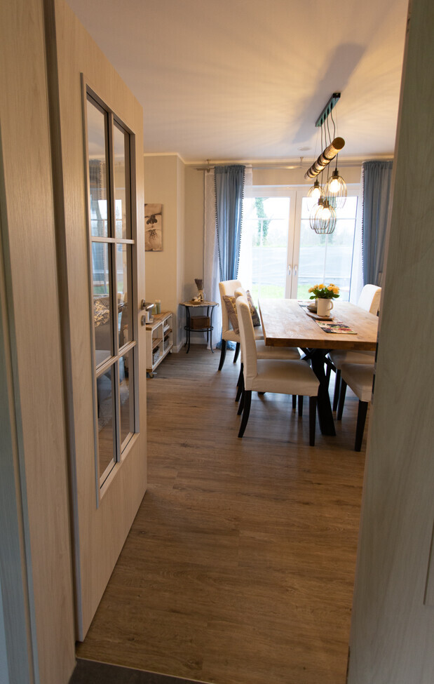

Here is a sample photo of our old vinyl floor in the newly built house. I still think it’s a nice floor, but you can definitely see that it’s not genuine wood — at least in my opinion.
kati1337 schrieb:
Here is an example photo of our old vinyl flooring in the new build. It looks good, and just from the photo, I couldn’t be sure it’s vinyl. It’s probably different in real life.
