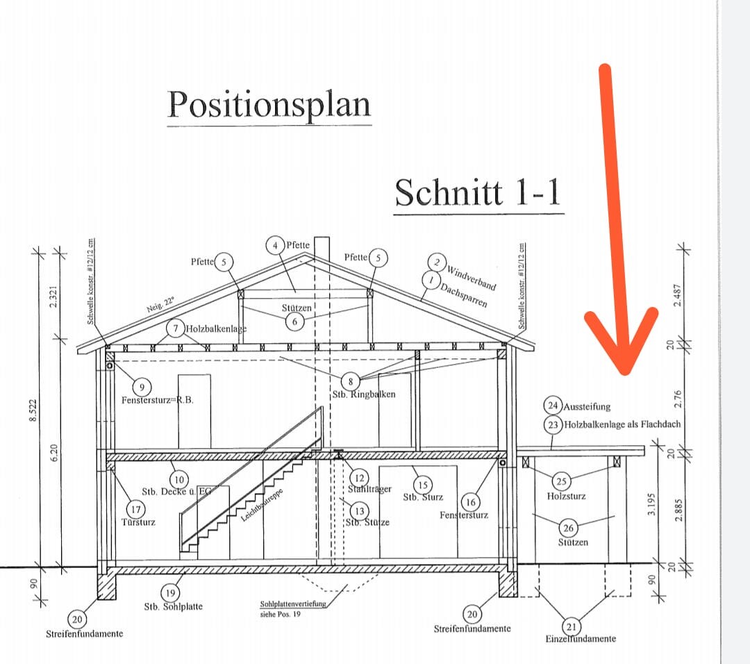

.. back to the terrace, attached is a design from acquaintances where this approach to floor level recognition was accepted.
So readers following along can see something 😉
Cross-section of a two-story wooden house with roof structure and staircase
11ant8 Dec 2020 15:44
KonstantinW schrieb:
and I then said that we don't want it that way.
No, that’s how you dismissed my post #13 – (at least to me) not Yvonne’s suggestion about the shortened knee wall. I was referring to lower rooms, if you want to rule out sloped ceilings in the first place.
