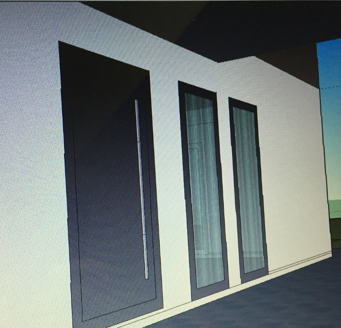

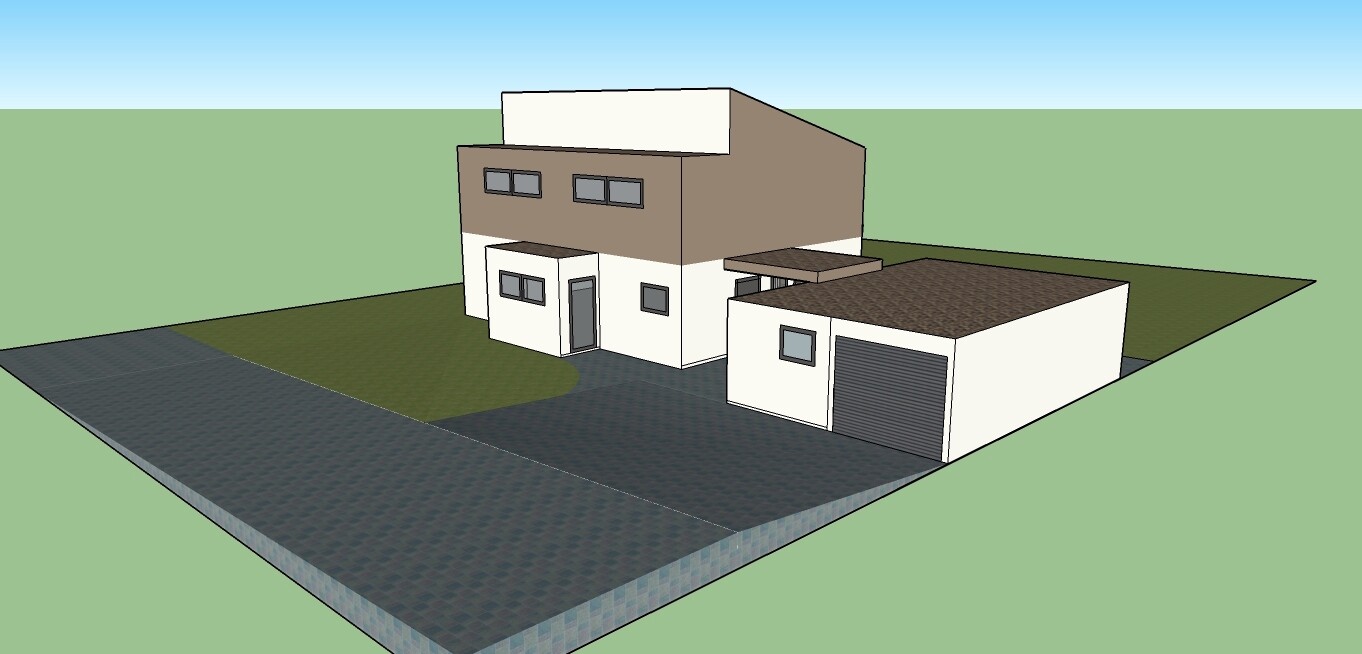

Here are two pictures of the construction project showing the entrance area.
I would like to have conduits (electricity and LAN) installed in the entrance canopy at the back left side (when viewed from the street), close to the house wall.
Does this work?
Modern house with brown upper floor, white facade, extension and garage block, driveway
HerrScheich24 Sep 2015 14:15
I would use a dome camera and install it at the end or beginning of the canopy, aiming it towards the door. In my opinion, it cannot be completely concealed.

I only just saw your designs afterward: don’t you see the visitors through the side windows?
