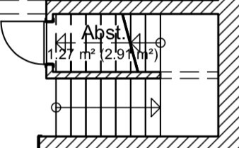

can someone tell me how to calculate the living area in a storage room under a staircase?
And what do the two square meter values in the picture represent?
Thank you very much!

11ant8 Jun 2018 01:29
Under 2m (6.6 feet) in height is weighted at half, under 1m (3.3 feet) in height is not counted at all – these factors explain the difference in the reported floor area.

But the 2.91 sqm (31.3 sq ft) won’t be the entire staircase, right?
11ant8 Jun 2018 19:54
According to the drawing, the storage room is only located beneath the stair run at the upper floor level. This arrangement seems to fit well.
