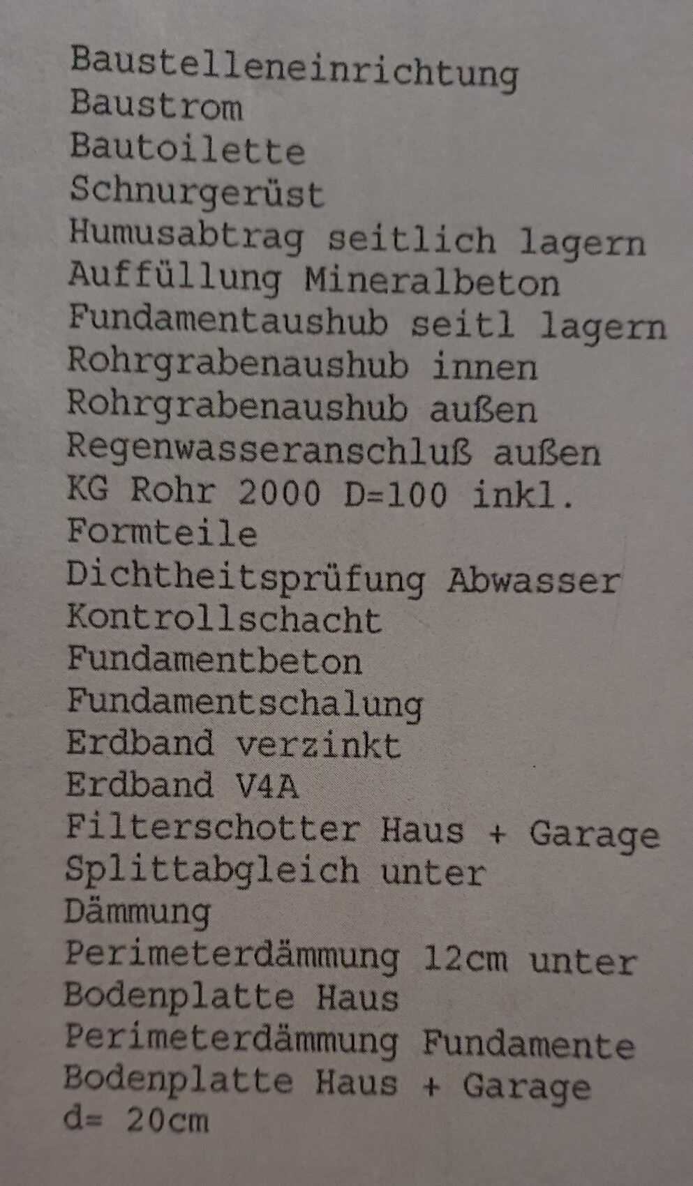

We have a current offer for the shell construction plus earthworks:
Double garage (6.2 x 8.5 meters (20.3 x 27.9 feet)) + house (9 x 13 meters (29.5 x 42.7 feet))
Here is the list of groundworks, strip foundations, and slab foundation.
Price: 45,500 euros net
Steel is not included. Costs 2,000 euros per ton
BW MR BW MR schrieb:
No, positions 1 to 8 are €30,000.
Here is the full breakdown.
[ATTACH type="full" width="845px"]69679[/ATTACH] Those are net prices, right? For foundations, standard concrete like C20/25 should usually be used, so without steel fiber reinforcement or anything else.
Two years ago, I paid €87/m² (roughly $9/ft²) gross—however, it was self-performed work.
Including the pump, labor, and so on, I would consider €150–160/m² (about $14–15/ft²) net to be fair.
Double garage (6.2 x 8.5 m (20.3 x 27.9 ft)) + house (9 x 13 m (29.5 x 42.7 ft))
Here is the list of groundwork, strip foundations, and floor slab.
Price: 45,500 € net
Steel is not included. It costs 2,000 €/ton (2,000 €/ton).
[ATTACH alt="kalkulation-streifenfundament-fuer-einen-bungalow-557902-1.jpg"]69685[/ATTACH] My offer is similar.
Is your plot level?
My offer is something like this,
Is your plot flat? Kind of...
There is a 0.5m (20 inches) height difference within the building area. The 0.5m (20 inches) would need to be filled with mineral concrete. It costs about 6,000.
