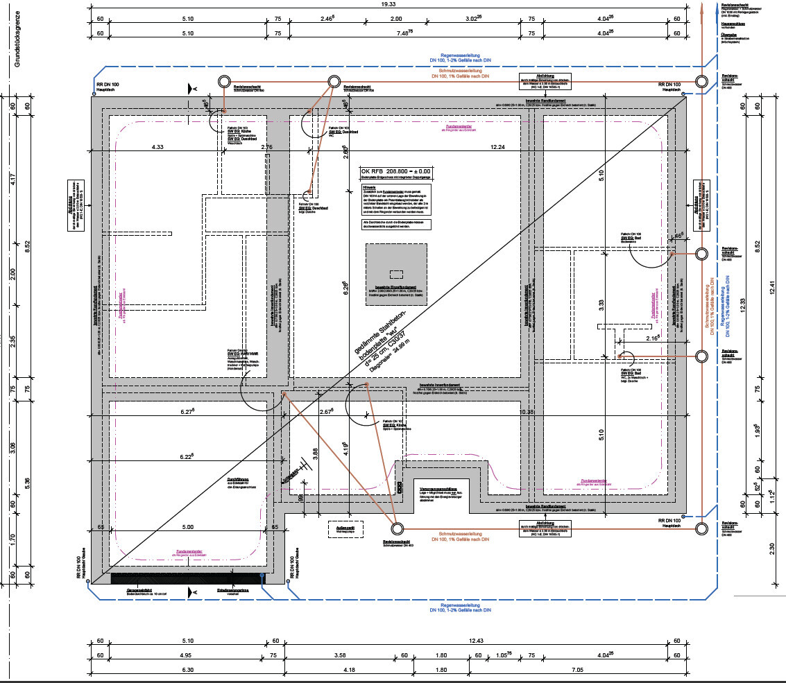

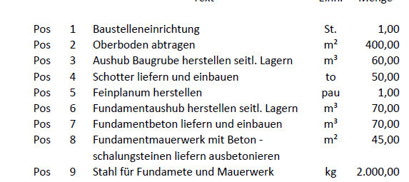

10 Feb 2022 09:38
Floor plan of a building with walls, doors, dimensions, and usage details.
Table with construction items: site setup, earthworks, excavation, gravel, foundation, steel
Here are the foundation plan and the scope of work.

10 Feb 2022 10:03
Not a good setup.
Too little square meters of topsoil (scaffolding, workspace?).
How thick is the topsoil?
Where will the topsoil be stored?
For the excavation work, the existing heights and the geotechnical report must be known.
For the foundations in the PDF, I’m missing a magnifying glass, but you should be able to calculate that yourself using length × width × depth.
The structural analysis specifies the quantities of steel.

Topsoil and excavation material from the foundations will be placed on the side.
The foundations are about 70m³ (92yd³).
