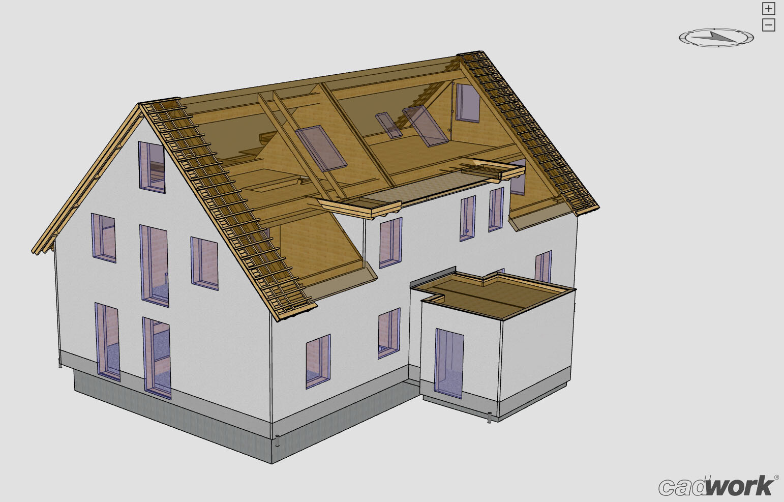

At this point, it’s still a gut feeling and "just" a rough calculation based on current offers (windows + doors, plaster, heat pump + controlled ventilation system, photovoltaic, etc.) supported by some orders (foundation slab, shell...), but I want to disagree with you.
KfW40+ can be cheaper (depending on the circumstances) than building according to the Energy Saving Ordinance, thanks to the current high subsidies. I don’t want to share exact numbers yet, but we will (believe it or not) come in at well under 2000€/m² (gross) including all costs (of course without the land). I’m emphasizing those two words because “well” means well, and these numbers seem to be important here.
And: We are getting an external technical room (and building to KfW40+ or Passive House standard!). We have already received all approvals (Progress NRW, KfW), so it is certain that this works. The external technical room is not inside the thermal envelope used for calculations! It must, of course, be frost-free. That’s basically it... P.S.: Our architect is also our energy consultant.
Here is a picture of our house. The technical room will be built exactly on the boundary.

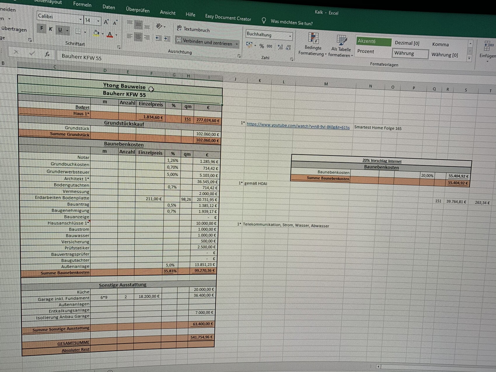

TangoDeltaLima9 Sep 2020 17:54We have currently scrapped all our previous plans.
We will no longer go with a prefab house.
We are now building a KfW 55 standard house using ytong blocks, working with an architect. Whether we will install photovoltaics and an energy storage system right from the start is still undecided.
For us, it is most important that the house’s structural design is correct. Everything else can be decided later.
