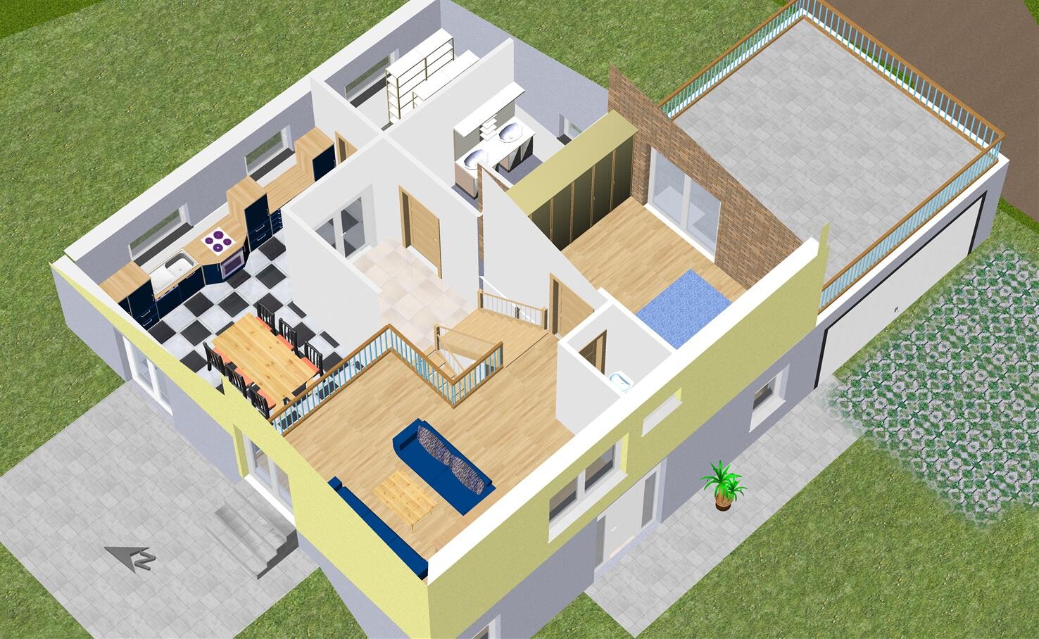

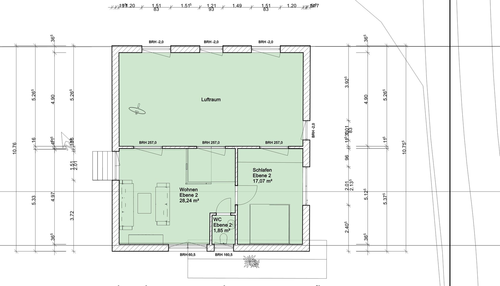

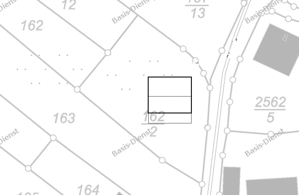

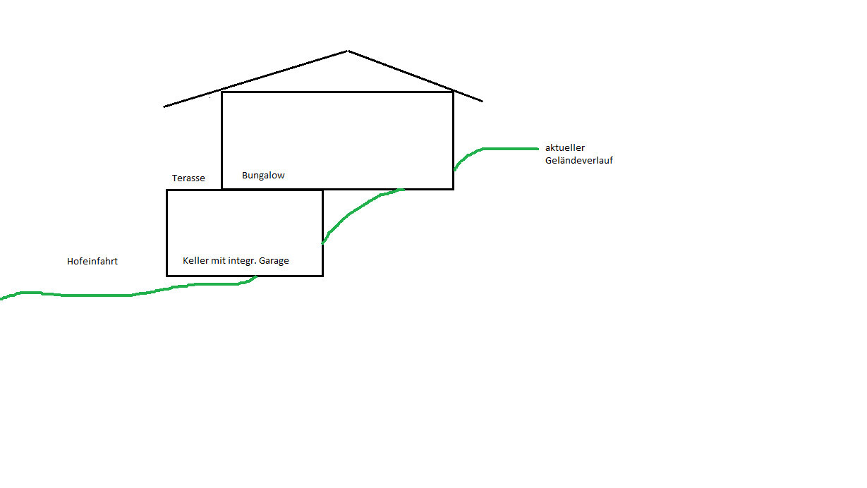

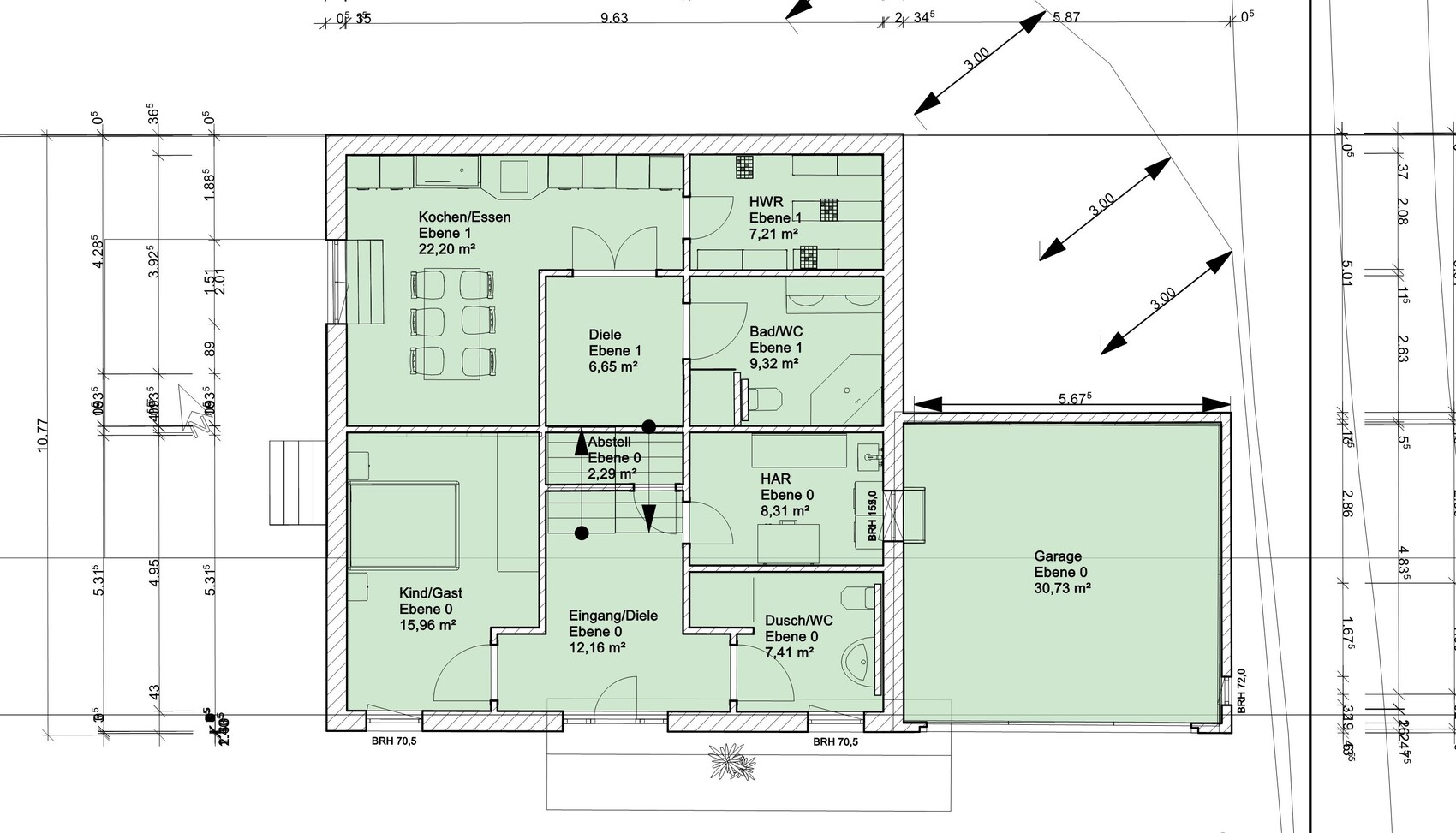

Attached you will find a cadastral map and a rough idea of the exterior view from the street.
(The current slope is shown in green.)
I am open to any suggestions. Thank you.
