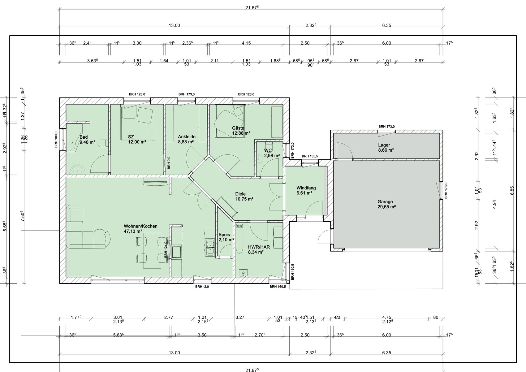

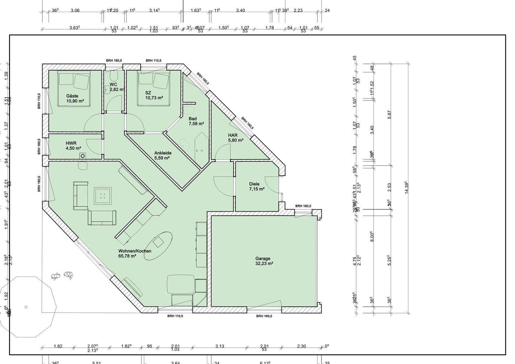

Thanks for the reactions and constructive feedback.
Of course, this is an amateur design...
We have gathered more ideas and input.
The basement will probably be dropped, at least with an integrated garage.
The garage will then be detached from the bungalow.
What does the group think about the attached revised bungalow floor plans?
All are between 120-125 square meters (1292-1345 square feet) of living space, each with a double garage located to the right side of the house.
The driveway will be on that side. The street runs from bottom to top on the right side.
North is at the top. The plot slopes downward from north to south.
Looking forward to your opinions.
Matthew0326 Apr 2019 10:26Phew... you really seem to be a fan of everything angled?!
The third option just doesn’t work at all, because with all those slanted walls it’s hard to use any room properly, not to mention the maze-like layout. To top it off, two bedrooms are positioned right next to the bathroom, so the occupants would have to listen to someone using the toilet…
The second option: where do guests shower? Having to walk through the dressing room and bedroom? That would be a deal-breaker for me.
The first option is the least problematic, but the dressing room won’t work—1.7 meters (5 ft 7 in) wide minus 60 cm (2 ft) on each side for closets equals no. However, if you straighten out the unnecessary angled walls, it has potential for expansion.
Others will probably find more issues; this is just a quick first impression…
