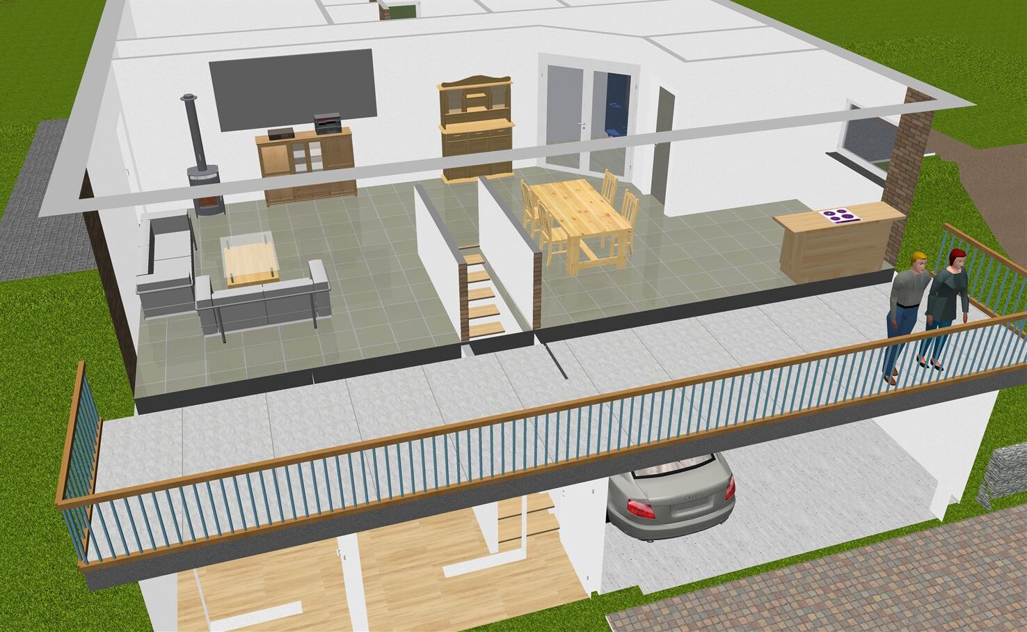

User0815 schrieb:
What? Is the basement staircase coming up or down right in the middle of the living area?I agree. The floor plan is quite unusual. That long hallway from the entrance would drive me crazy. You’re always looking straight down a narrow passage. The kitchen is also relatively small.
I’d definitely wait a bit longer before finalizing the floor plan. There are users here with really good advice that you should listen to. You can definitely get a lot more out of the house without causing a major cost explosion.
Financially, it should be manageable. Your expenses will likely decrease in the coming years once your child moves out… although it’s probably better not to say that too loud.
A partial basement does not save as much cost as is often assumed. Additionally, problems are more likely to occur with a partial basement if there are any ground settlements.
Depending on the soil, settlements in buildings are not uncommon. If the load can be evenly distributed, this is not an issue. With a partial basement, however, the effort required is greater.
User0815 schrieb:
Huh? Does the basement staircase actually come up in the middle of the living area?Yes. That was actually the plan. I know it’s not everyone’s preference.
But it’s also meant to function as a room divider. It’s easier to see that in the picture without exterior walls.
