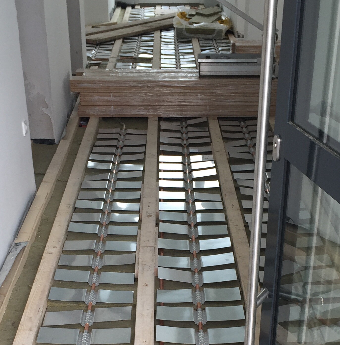

katara133717 Jun 2020 12:01With or without underfloor heating? It’s best to ask the manufacturer of the wooden planks how the installation should be done. We had a customer who also wanted real wood planks, and that only worked with a special underfloor heating system, as shown in the picture.
If engineered hardwood flooring is planned, it might not be as complicated.
