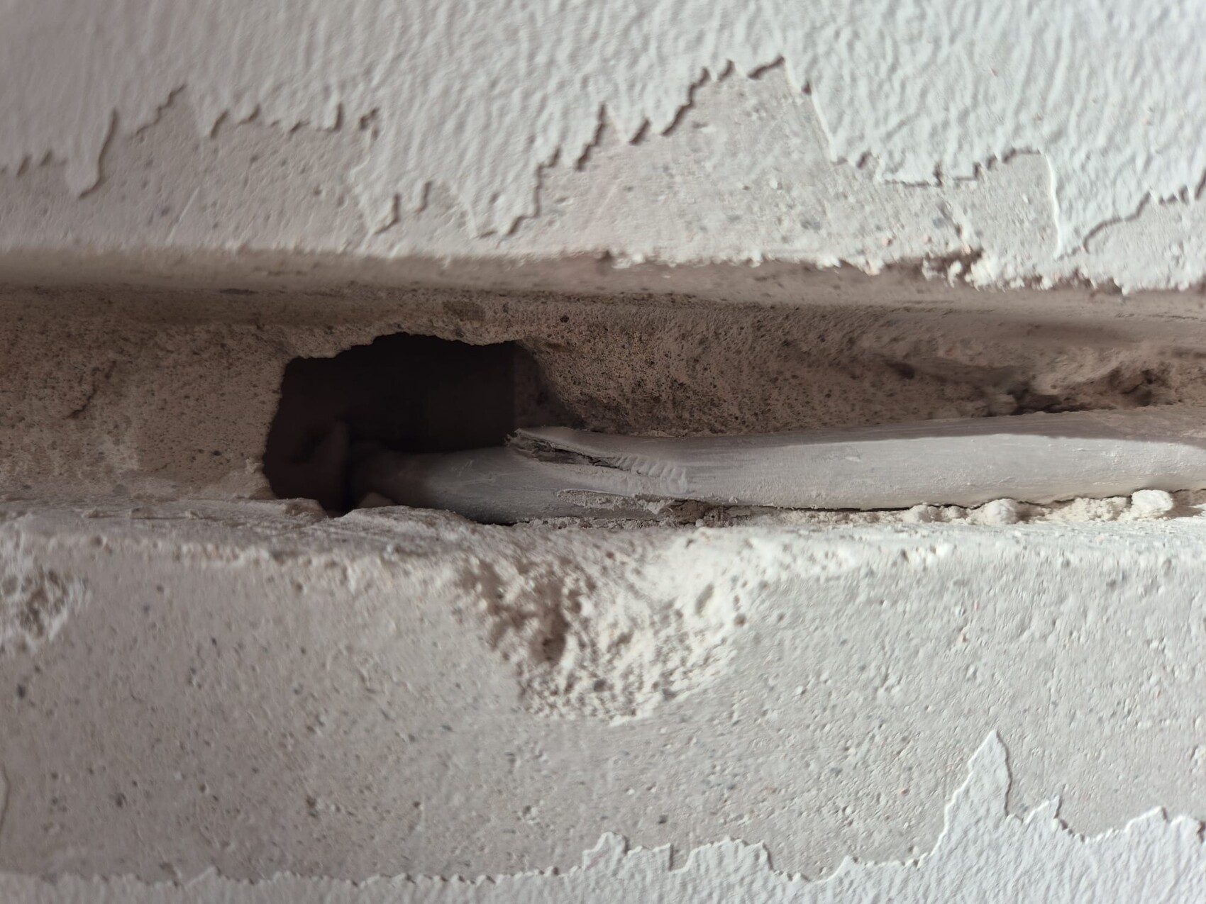

Yesterday, I chased channels into the sand-lime brick of an interior wall for the flush-mounted cables behind the sauna insulation and paneling that will soon be installed. At a distance from the flush-mounted boxes, where I no longer expected or was looking for any cables, I accidentally nicked the jacket of a NYM 3x1.5 cable over a short length (2cm (1 inch)).
The filler inside the cable is intact, as is the insulation of the individual conductors; the cut only scratched the cable jacket, so you can see the filler material (see picture).
Is this
a) a real problem because of possible chemical reactions between the filler/conductor insulation, the sand-lime brick, and moisture or the plaster I will use to seal the channel, which could damage the conductor insulation,
or
b) solely an issue from the point of view of electrical regulations such as VDE or our insurance, in case any cable problems ever arise in that area, since the cable jacket mainly provides mechanical protection in an otherwise dry environment but must remain intact according to the rules, or
c) both, or
d) neither?
If it is a problem, what would be a VDE-compliant solution?
I could detach the cable from the rest of the wall and apply heat shrink tubing at the damaged spot, or—more involved, since I would need to carve out some additional space—I could install a cable joint sleeve.
If anyone feels the need to give additional advice on electrical installations beyond my question: the electrician will see everything and will be the one to connect the sauna heater in the end. I just don’t want to bother him with questions every other day before then.
Is this
or
c) both, or
d) neither?

Teimo19882 Dec 2024 18:30If neither the RCD nor the circuit breaker trips, heat shrink tubing should be fine. If you don’t have an RCD installed beforehand, then it would be worth considering.
Of course, this is just a personal opinion without any liability or guarantees.
