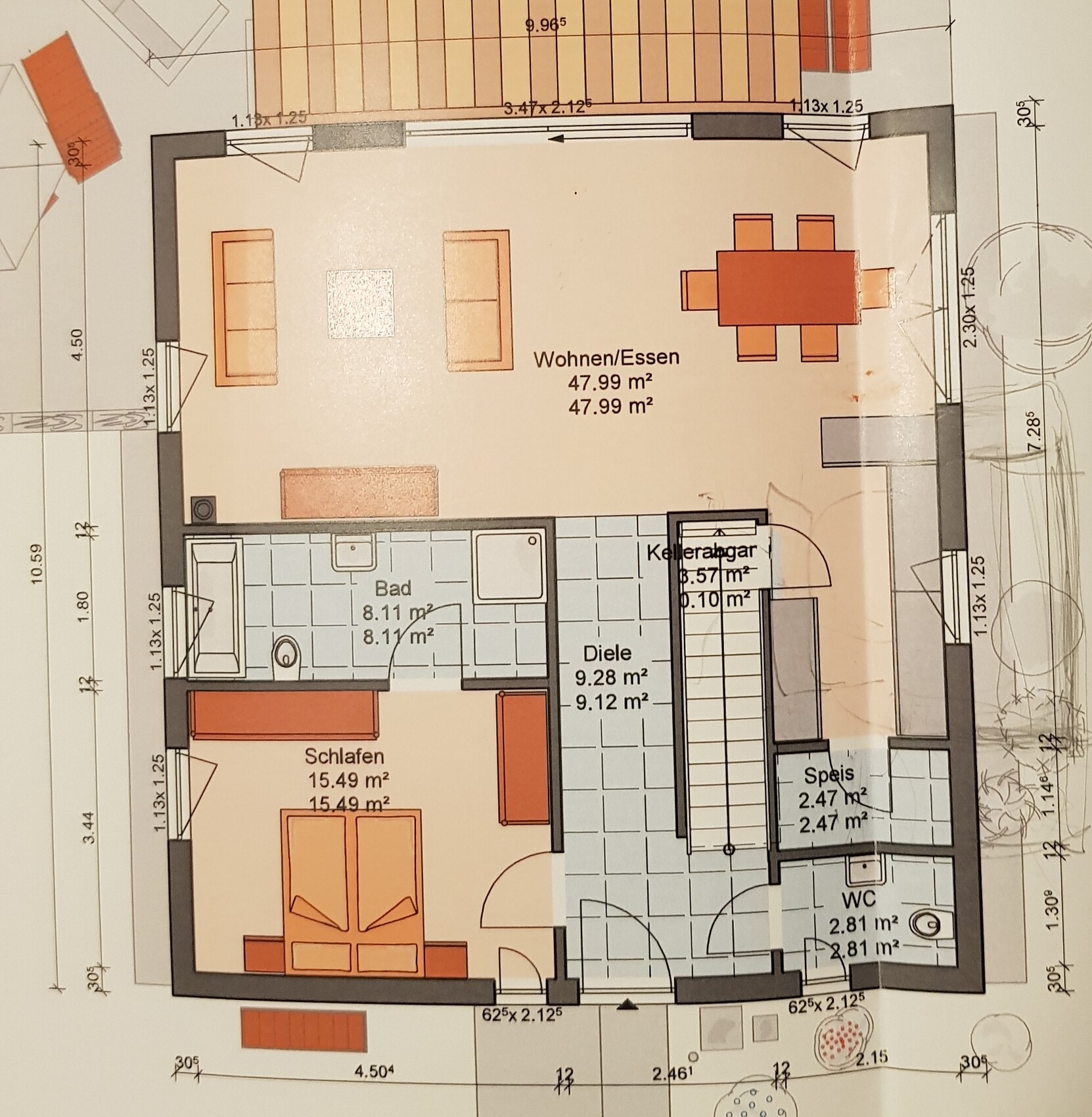

Good evening everyone,
Due to the limited availability of existing properties and some very specific requirements, we are planning a single-family house with a few special features. First of all: I am open to all suggestions and also welcome honest, well-founded criticism.
Some basics:
1. We have two children (3 and 1 years old) and are planning for a third, so there will be five of us eventually.
2. DIY work is almost out of the question. Only painting and laying carpet flooring in the basement are tasks we feel capable of doing ourselves.
3. I definitely need a separate home office since I mostly work from home (planned in the basement, see below).

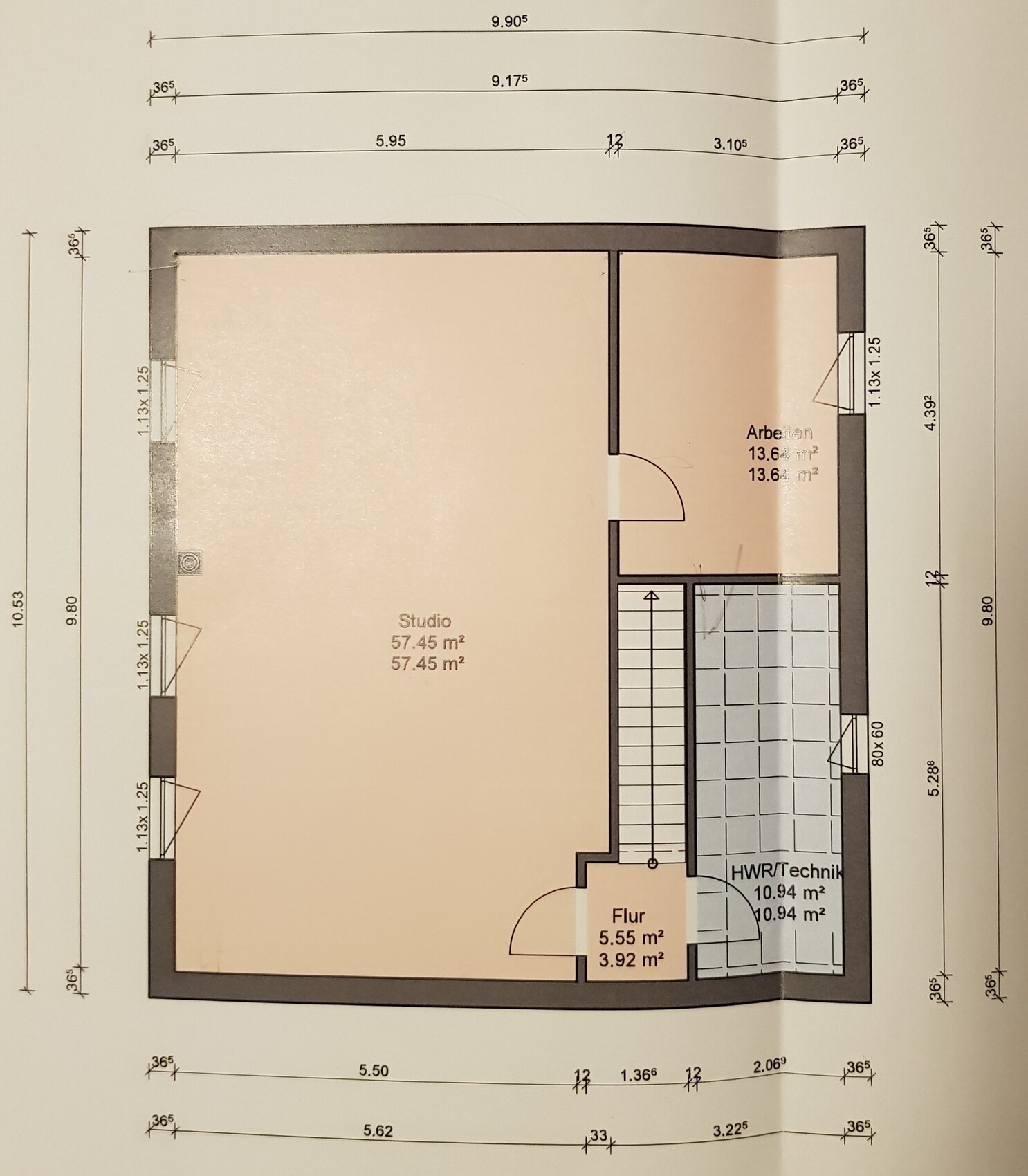

4. A very large hobby room is a must in the basement. It should be rectangular and at least 2.70m (8.9 ft) high (hence basement ceiling height 2.70m).
5. We want to be as uninvolved as possible in the construction, so we have only looked at prefab house providers so far and would currently prefer a turnkey construction.
6. WE DO NOT HAVE A PLOT YET! Therefore, the house has been designed so that its roof and number of floors should fit many potential plots roof pitch 35 degrees, knee wall 120cm (47 inches).
Today we received an offer from the prefab house company that seemed "quite suitable" to us so far. The salesperson was to consider the following requirements in addition to those mentioned above:

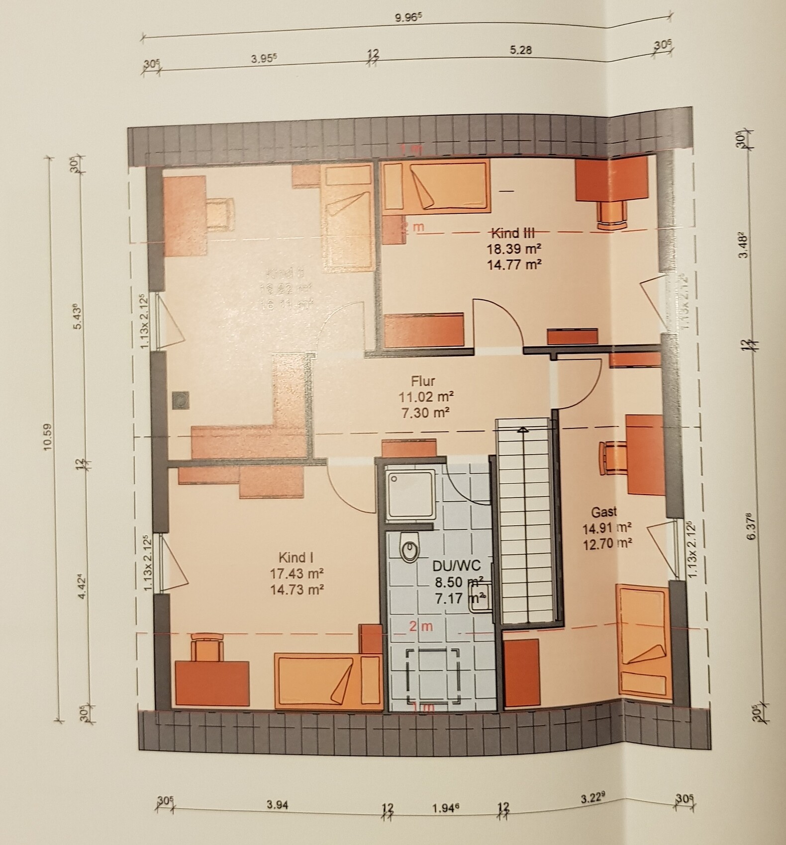

1. The children should live on the upper floor. In addition, a guest room/home office (for my wife) should be included there.
2. The master bedroom should be on the ground floor with its own bathroom. A separate guest toilet should also be on the ground floor.
3. My wife wants an open L-shaped living/dining room if possible.
4. A small separate pantry should be located behind the kitchen.
5. We are not into "frills." Large galleries, huge bathrooms, big hallways, etc. are considered a waste of space and money. So rather functional and practical.
Our initial assessment
Without preempting your professional opinions, we find the following aspects of the proposed floor plan problematic:
1. The biggest concern is the kitchen’s width of only 2.15m (7 ft). This is unacceptable. The seller then suggested extending the kitchen by 1.20m (4 ft) with some kind of "addition" (sorry, I don’t know the correct technical term). However, this extension would cost at least 12,000. We were not very enthusiastic about this idea.
2. The guest/home office on the upper floor also seems impractical for the same reasons.
3. In general, I find the angled room for child 1 on the upper floor not ideal to use.
4. Isn’t the master bathroom too narrow at 1.8m (6 ft)? Of course, we are slim but these dimensions seem tight.
5. I consider both the type and location of the staircase suboptimal. I would prefer it on the side, and we want a continuous staircase from top to bottom, not one that leads down through a separate door as shown in the plan (not a dealbreaker, but feels odd to us, especially given the already narrow kitchen…). What kind of staircase would you choose? Where would you place it?
6. Is the arrangement of the bathrooms acceptable? From a layman’s perspective, I thought that at least the children’s and parents’ bathrooms should be above each other.
7. How do you assess the lighting situation through the windows? We find it suboptimal in some rooms. A bright house is very important to us! Where else would you add windows?
8. Surely subjective as with many things, but how do you evaluate the fact that my office is in the basement? I will be spending a lot of time there.
Thank you very much for every suggestion! I am aware we are still at a very early stage, but our goal is to have a "reliable" floor plan soon that will largely be set (I understand that the layout of rooms will ultimately depend on the specific plot and might require further adjustments).

kaho674 schrieb:
Hello @HsweetH
A floor plan discussion without the plot of land is unfortunately completely pointless. Come back once you have the land. Good luck with your search! a) this^ There are simply too many points in a development plan / zoning plan that can cause problems later on.
b) something is missing with the numbers. There are additional costs. Have you accounted for them? With extra costs, you will easily pay 500,000+ for the house.
c)
HsweetH schrieb:
5. We want to be as uninvolved as possible with the construction, so so far we have only looked at prefabricated house providers and would currently prefer such a (turnkey) build. This has nothing to do with prefabricated houses. Whether the building site is empty because the house is mostly produced in a factory and then assembled on site, or whether a team of masons is coming and going doesn’t make a big difference. It’s mostly a matter of belief.
Aside from the fact that the bedroom could be made 30cm (12 inches) narrower to give more width to the right side of the plan (kitchen, guest area), I don’t understand why the basement has to be accessed through the kitchen. Otherwise, the bathroom dimensions as shown here are practical for furnishing and fine.
That doesn’t add up. For a basement fit for living with a ceiling height of 2.70m (8 ft 10 in), the cost will be quite high, then another 170sqm (1,830 sq ft) on top of that… I’m expecting something starting with a 5. With additional building-related costs and the usual extras, then around 600,000. You also have to consider that the plot might not be suitable for a basement or that the plot is oriented incorrectly. And apparently, there are no more affordable good deals in your area, otherwise you would already have one.
HsweetH schrieb:
Price estimate according to the architect/planner: 415k for the entire house (DIN 277 living area ground floor + upper floor = 177m2 (1905 sq ft), basement 88m2 (947 sq ft))
Personal price limit for the house, including fittings: 450k
Preferred heating technology: I have no idea! Planned is a condensing gas boiler / underfloor heating (also in the basement!). Suggestions are welcome here as well.
hampshire12 Jan 2020 23:27Planning a house without a plot of land is like organizing a wedding without a bride.
Furthermore:
A seller who designs a floor plan for you without you owning a plot of land is either an amateur. Don’t buy from amateurs.
Furthermore:
HsweetH schrieb:
Due to the limited availability of existing properties and rather specific requirements, we are planning a single-family house with some special features. [...] 4. There is a mandatory wish for a very large hobby room in the basement, which should be rectangular and at least 2.70m high (8 ft 10 in). It is hard to disagree that these requirements are indeed quite “special” – however, “insufficient” certainly also applies to the layout shown. Even fitting these wishes into a standard two-story villa with a 10x10m (33x33 ft) footprint would be a challenge, but it is even less feasible in a one-and-a-half-story house with the same footprint (adding knee walls will not solve this). In comparison, it would almost be more effective to inflate a balloon next to a needle – a little more alignment between wishes and framework will definitely need to be worked out.
