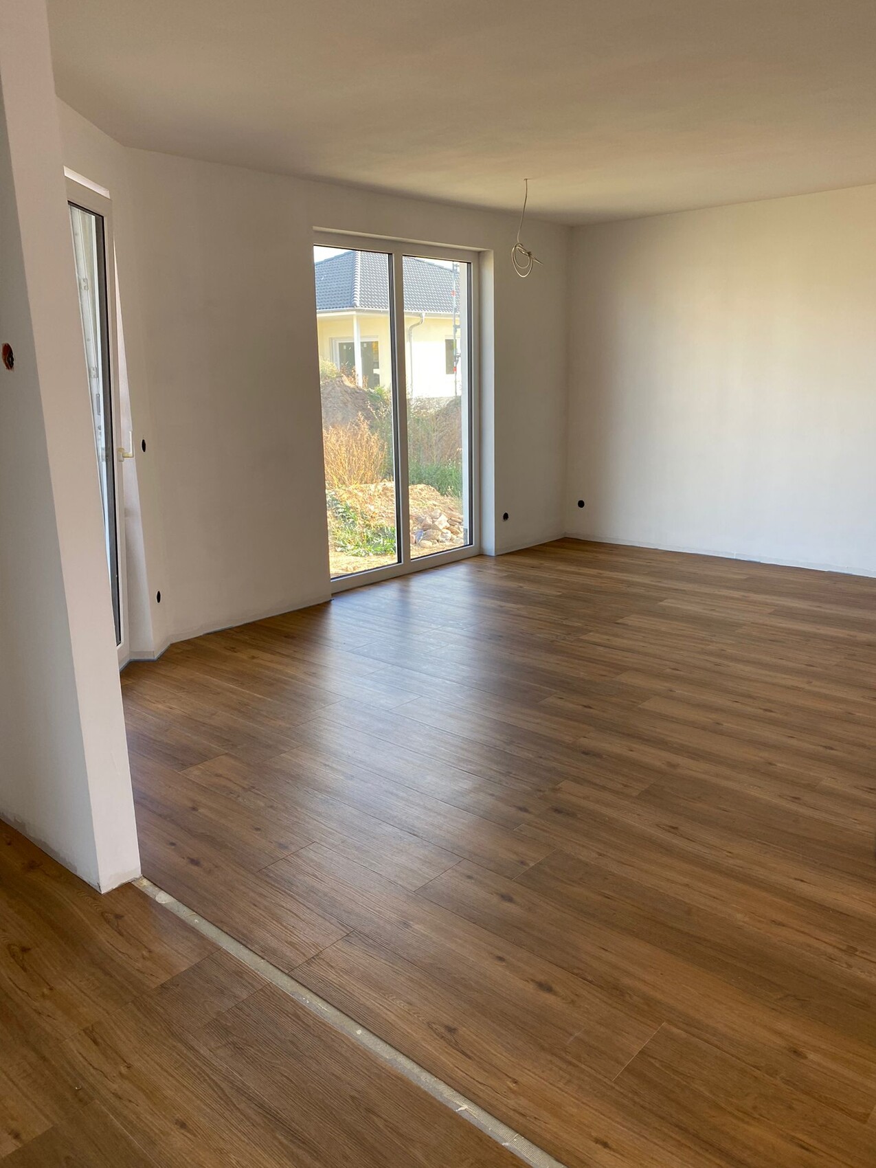

Gooosee15927 Jan 2023 07:10@Reggert It definitely looks good.
This is meant for gluing, and as a layperson, I wouldn’t trust myself to do that, so I would prefer to install it as a floating floor.

It was more as a reference because nothing specific was mentioned about the type, and I couldn’t find anything about it on the manufacturer’s website either.
