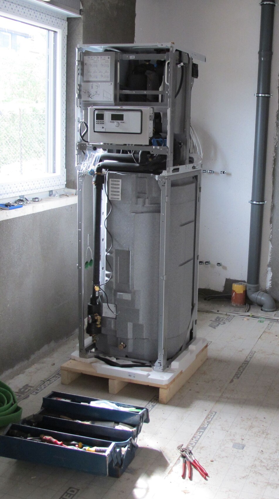

I do believe that the later conversion will also involve significant costs. By the way, the water storage tank is integrated into the tower. At least, that's how it is with our Vaillant air source heat pump. I’m sure some of the pipes would also need to be rerouted.
