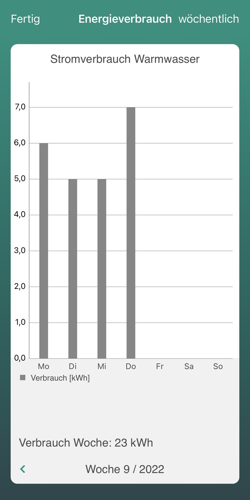

This week I had very low electricity consumption for heating (probably due to the sun), but the hot water preparation might still need some optimization....!?
Bar chart: weekly electricity consumption for hot water; Mon 6, Tue 5, Wed 5, Thu 7 kWh; Week 9 / 2022
Weekly bar chart: heating electricity consumption (kWh); peak on Tuesday, total 11 kWh.
