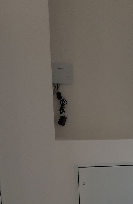

Good question, I had the module connected during the initial installation. It might have been possible to do it myself, but then there’s the issue of the warranty... so I had it done at the same time. I’m always cautious with retrofits while the device is still under warranty.
It was also important to have a network cable there. Since the switch is very close to my setup, installing it and connecting it to the internet was very quick.

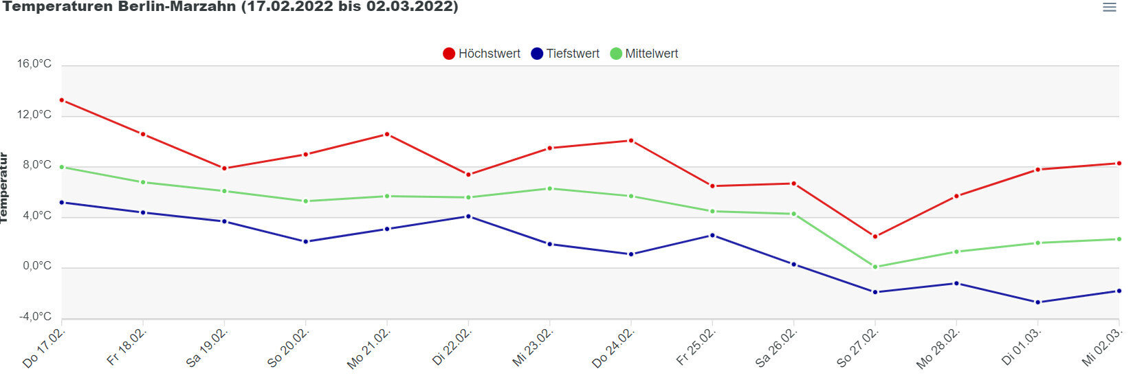

Temperatures in the district over the past few days:
Today, we had no sunshine at all, and despite a desired temperature of 18°C (64°F), I had 22°C (72°F). Could it be that the heating ignores the setpoint and regulates itself solely based on outdoor temperature and return flow temperature?
Tolentino schrieb:
So today we had no sunshine at all, and despite a desired temperature of 18°C (64°F), I had 22°C (72°F). Could it be that the heating ignores the target temperature and controls itself solely based on outdoor temperature and return flow temperature? Ignoring the indoor temperature and operating purely according to the heating curve is optimal for efficient operation. At the professional trade level, this setting would be called "room control off," if I’m not mistaken. Then the target temperature setting is only responsible for the parallel shift. The base should be 20°C (68°F).
