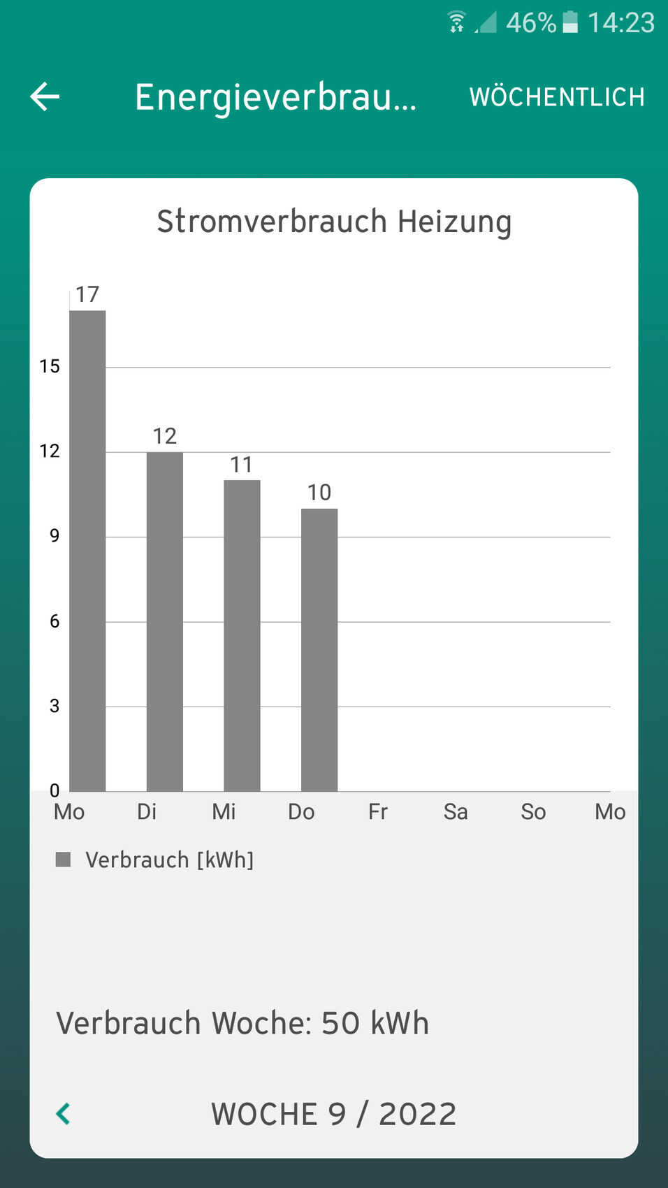

Mahri23 schrieb:
Used 26 kWh yesterday.Wow! Was the electric heating element running then? Or was that due to constant defrosting?KingJulien schrieb:
Wow! Was the heating element involved there?No, it only switches on below minus 15°C (5°F). It hasn't been activated yet. Yesterday's weather was really damp and chilly, almost at freezing point all day. The system defrosted nearly every hour. The days before, consumption was around 8 to 10 kWh.
I haven’t checked for a while, so I couldn’t see if it’s still “leaking.”
The day before yesterday evening, after 4.5 days, the meter showed 90 kWh, which doesn’t seem great. We had temperatures around -2°C (28°F) at night and between 0 and 7°C (32 and 45°F) during the day.
It was damp and foggy over the weekend. The last few days have been rather dry. I’ll check again this evening.
By the way, how do you access those graphs you often post here? I can’t find anything like that in the menu structure. Do you need the internet module and the app? Or is there a USB port somewhere to download log files?
