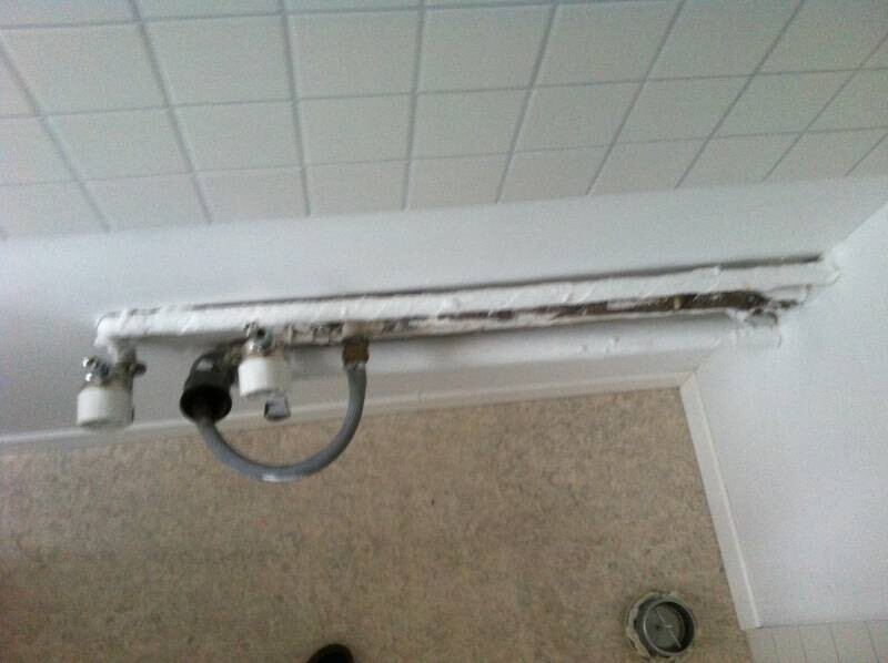

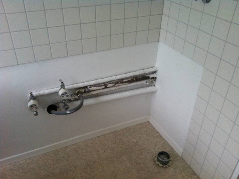

In my new kitchen, the water pipes come from the side. Pictures here
Therefore, I cannot place the units directly against the wall. My plan is to screw a strip of countertop or square timber about 10cm (4 inches) wide along the full width of the kitchen (about 3m (10 feet)) at the height of the finishing strips of the Udden units onto the wall, then place the units in front of it.
- What do you think about this solution?
Also, I have another question: does the sink have to be installed directly above the drain pipe, or can it be positioned just to the right of it?
That leads me to my next question: is it possible to change the sink position on the Udden countertop? Currently, the sink is on the right side. Can I install it on the left side instead?
Best regards!
Best regards!

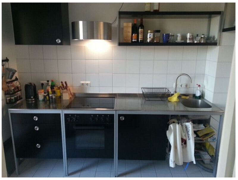

This is what the used one looks like:
However, my water connection is about 1m (3 ft) away from the wall. So where the drain is now.
Is there perhaps some kind of metal cover that can be screwed over the opening?
