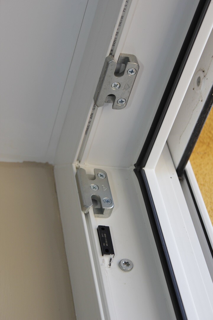

Interesting. I'm too clueless to understand everything that is possible.
We also have contacts on everything that can be opened.
It is also possible to distinguish, meaning to display the status of the window (open/tilted/closed), and this can then be connected to an alarm system.
I didn't know it could be combined with roller shutters.
