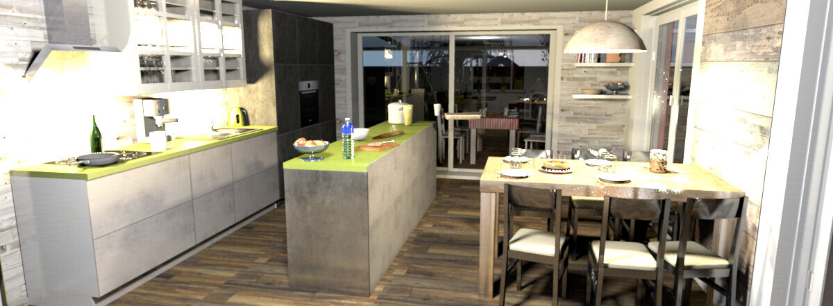

It’s nice that you’re giving us an update and checking in again. In the dining area, there’s a stove standing all alone in a wide open space – is the rest of the kitchen a secret?
Oh yes, the cooktop
More or less for no particular reason. There were different kitchen layouts.
There will also be a small kitchen island with a depth of 60-70cm (24-28 inches).
The cooktop and sink are, however, installed in the counter along the wall.

The color combination is just for fun. Yes, that would be a bit too much Neo-70s style for me too.
Grit Stephan schrieb:
The detailed kitchen planning is not yet finished. There is often praise here for a specific kitchen forum. However, I haven’t visited it yet, which means you have to manage without my usual linking service.

j.bautsch2 Nov 2019 16:54As @11ant says, head over to the forum, the planning is still really not finalized.
I’m currently looking for a two-row kitchen… but I’m unsure which platform to choose…
For the color, I have initially given my kitchen planner two directions.
A year ago, I was always thinking about that “concrete” look, but I’ve moved away from it.
At my workplace, it seems like only this concrete look, also called “cloud,” has been sold this year…
Yes, I work where quite a few kitchens are sold… but there is no time left for colleagues… My first own kitchen plan has been at the kitchen studio for 1.5 years… right at the bottom of the pile.
Everyone is under a lot of stress… so it’s just the usual madness.
