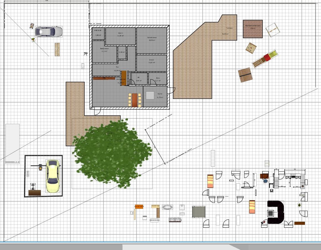

After three visits to the site and further considerations, especially regarding the sun, I arranged the walls today as the living area would be positioned in our 1.5-story plan. (Only now we are directly next to the ditch, with the corner facing east).
This way, we would definitely use the garden towards the garage (with a patio door from the living room) and the back garden (patio door from the kitchen).
The question now is how to properly orient the other rooms... I would also be open to which direction the bedrooms face in this plan.
The drawback here is that we are close to the ditch and somehow separate the garden. But if the rest can be arranged better this way...? And the bedrooms wouldn’t be on the quiet side... or rather the children’s rooms wouldn’t face the garden... but if this allows more light into the living area...
The house is still a rectangle/square, partly for cost reasons. Storage space is planned in the utility room and attic.
However, I still have no clear plan on how to arrange all the other rooms in a sensible way.
Two children’s rooms, utility room (which makes sense towards the street?), with storage room or separate area (a small staircase to the attic, like in Nordlys, would be great), bathroom, guest toilet, and a small office. Gable roof.
Please ignore the terraces in the picture; they are not finalized. My focus was solely on the “living area” and its relationship to the garden and ditch...

The house is still a rectangle/square, also for cost reasons. My favorite floor plan for your building project is the Eskjohus bungalow suggested by kbt09 in #56. With a gable roof, I consider it cost-effective.
My favorite for your building project is the floor plan of the Eskjohus bungalow suggested by kbt09 in #56. With a gable roof, I see no cost issues.Thanks for your feedback.
I also wanted to ask about the costs.
But it’s already a few thousand more. Just between the L-shaped bungalow and the rectangular one. And in this case, the roof area is even larger than for 132m² (1420 sq ft) of living space, since not only the living area is considered.
Or rather, the internal area between the three rectangles probably also requires a foundation slab.
Well, I can report back once I know more.
Could you please upload the floor plan from 129 scaled down to just the house layout with one or two dimensions? It’s difficult to make out much from the current version.
You keep mentioning a trench... are you referring to the 6 meters (20 feet) that you have to keep as a setback from your property boundary? I understood that the trench would be located after those 6 meters (20 feet).
Is the position of the large tree really accurate? Like, about 15 meters (50 feet) from the side where the street is?
kbt09 schrieb:
Could you please upload the floor plan from post 129 again, but only as a house floor plan with one or two dimensions? It’s hard to make out much from the current version.
You keep mentioning a trench... are you referring to the 6 meters (20 feet) minimum distance you have to keep from your property boundary? I understood that the trench would be located beyond the 6 meters (20 feet).
Is the position of the large tree really like that? So roughly 15 m (50 feet) from the side where the street is?The tree is approximately there.
I should probably go and measure again.
About the trench: the slope is quite steep.
We think that about 1 to 1.5 meters (3 to 5 feet) of the slope belong to the property.
The poplar tree is on the property and stands exactly at the start of the slope.
Only an official authority could measure this precisely.
In your plan, I believe the garage was also placed right on the building boundary line?
And the floor plan will be provided later.
