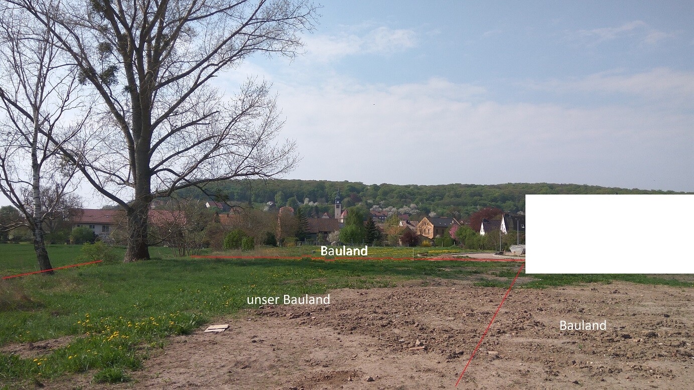

Regarding the idea of having the living room facing south, with windows on the east, south, and west sides—either as a bay window or an L-shape—and the bungalow being wider than the current railcar-like layout:
On paper, there is enough space, but when we stand on the plot, it feels like we are taking up too much space along the long side, or we somehow split that “strip” there. (the poplar tree is about 3-4 meters (10-13 feet) into the plot)
That’s why the living room ended up on the back, facing east.
We “tried” standing at the house corners, and from there the strip toward the ditch doesn’t feel like enough space to build on… and at the back, facing east, there is a nice large area that gets sunlight from all sides, at least as long as the trees to be planted don’t shade the entire plot—which the poplar already does further forward. (But it’s already settled that we are allowed to prune at least on the property side. (the timing is still open))
If I place the L-shape kind of backwards, rotated (so the bay window is where the sofa is now in the railcar), it gets tight again near the ditch, right? I think we really need to mark it out with a tape measure and then see where we end up.
We probably just have no sense of the “dimensions”…
How far the walls on the side would reach, how they change the views or break up the space, or something like that.
Or maybe we should first set up a scaffolding with tarps and cloth on the plot.
It really is hard to estimate lengths and heights.
Offenes Baugrundstück mit Baum im Vordergrund, Dorf im Hintergrund
Edit: I took the photo standing at the northeast corner here.
