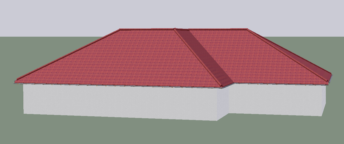

If the building authority won’t approve a flatter roof, I would seriously consider a two-story house, which is allowed according to the development plan. With a 14m (46 feet) width, you have nearly 6m (20 feet) of clear height under the ridge in the attic space—which would be an unused room otherwise. It would require a bit more effort, but I wouldn’t expect disproportionately higher costs since the floor area would be smaller. Plus, you would automatically have mostly rooms with two exterior walls, which means more natural light inside the house.
Obstlerbaum schrieb:
With a width of 14m (46 feet), you have almost 6m (20 feet) of clear height under the ridge in the attic – in an unused room, no less. It would require some extra effort,The roof was not included in the design here – only considered conceptually.
This would already mean a very complex roof structure...

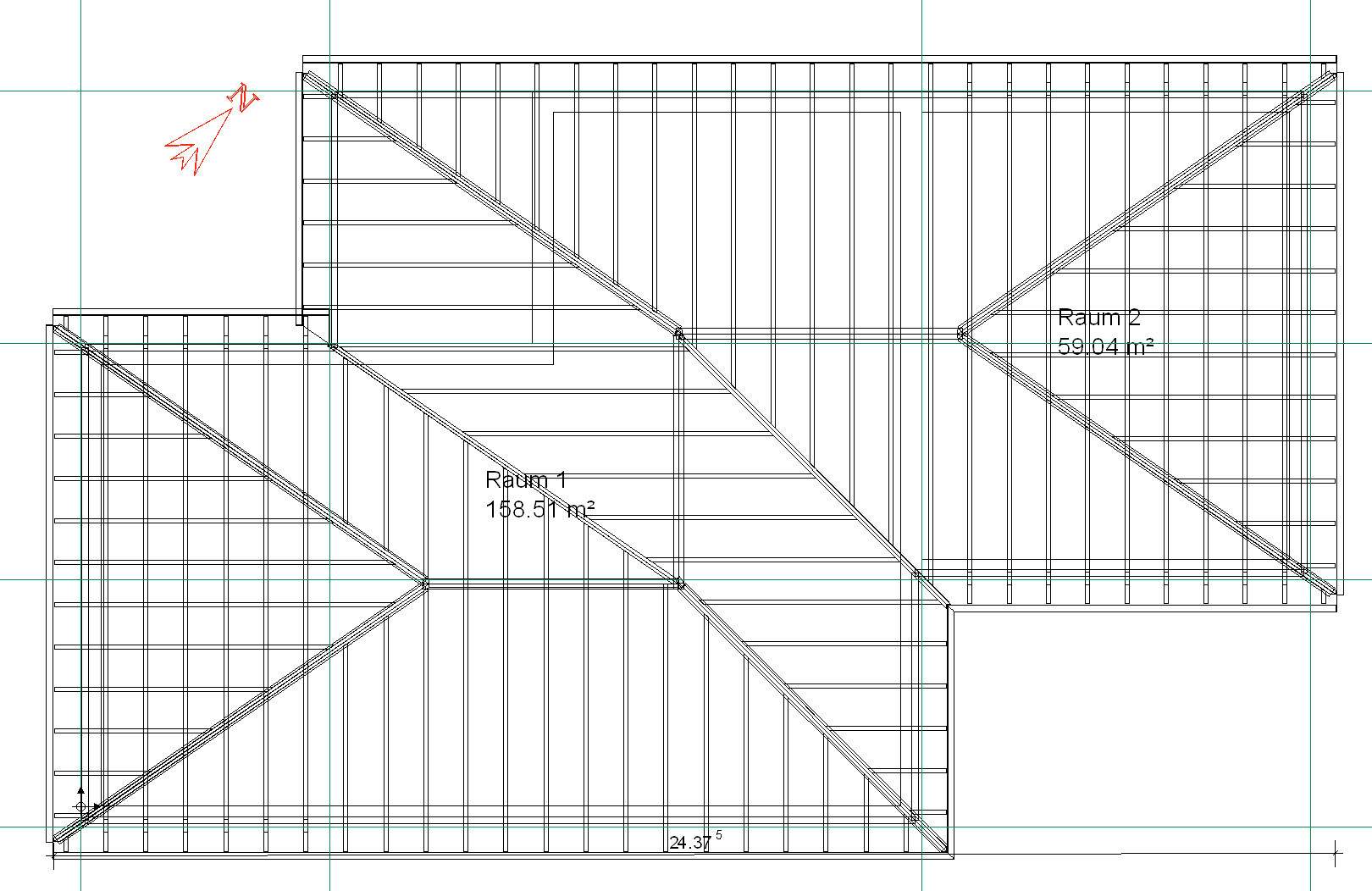

which at a 40-degree pitch looks like this (note: there is still some top view shown):
Overall, including the garage, we are talking about just under 24 meters (about 79 feet) in length (a bit less, as I included the roof, which would not have an overhang on the right side due to adjacent buildings). And yes, it would roughly be over 6 meters (20 feet) high, corresponding to two floors/two living levels. However, as drawn, the garage would not fit two cars because the garage door is not large enough.
Extending the house accordingly would not be reasonable.
With a building envelope depth of 20 meters (66 feet) and the mentioned orientation, basically any design that does not extend inward and open to the southwest is problematic.
Currently, the house is positioned widthwise and is working against the plot.
