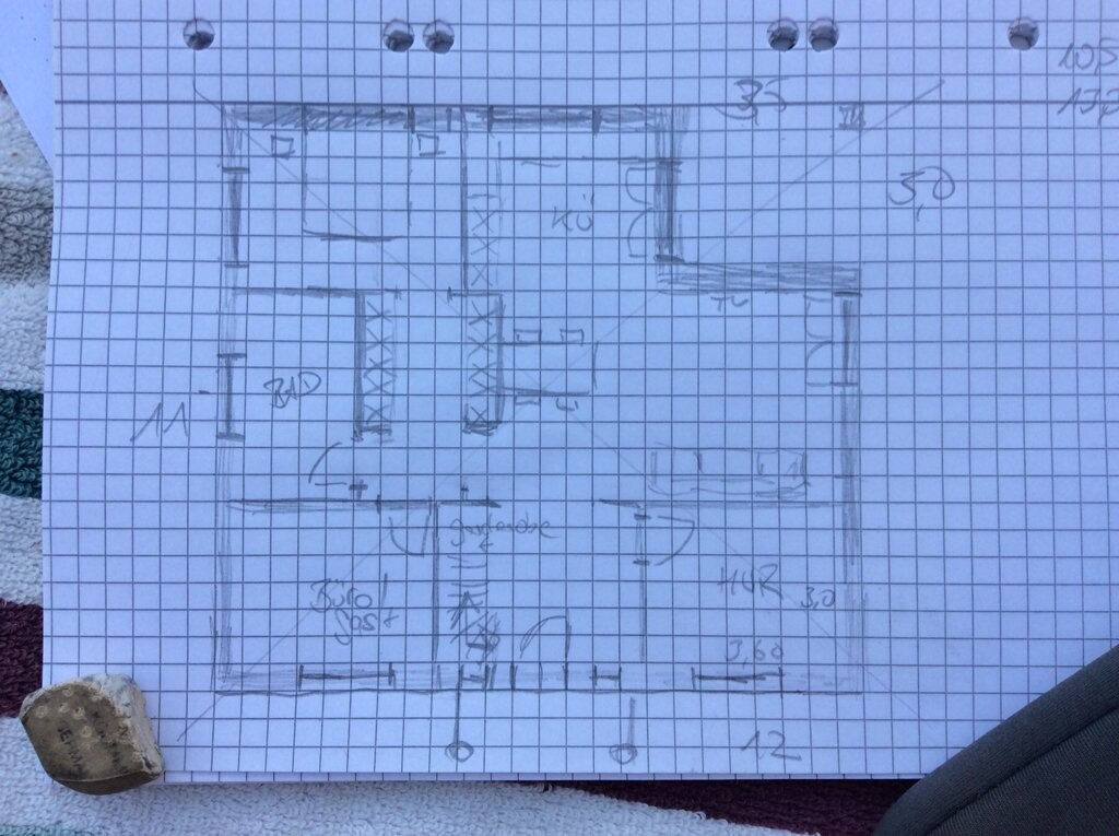

What is an Abschleppung? An Abschleppung is when the roof extends further down at one point, basically lowering the eaves at that spot. The advantage is avoiding awkward breaks in the simple roof shape that would otherwise occur with protrusions in the building’s footprint (like the entrance porch here). Visually, it smooths out the roof surface; structurally, it avoids having to create more complex geometry in the roof frame at those points.
I’ve drawn some walls and ended up with about 11 x 12 meters (36 x 39 feet), while you have 10.5 x 13.3 meters (34 x 44 feet), so roughly the same size.
However, my areas are better zoned. The utility room is over 10 sqm (108 sq ft), and you can now place furniture under the covered area as well.
I could make it smaller with a drawing program, but it’s not necessary.
Many walls can be decorated and furnished symmetrically. The staircase, whether built later or now, has space, even if it ends up a bit narrower. If it’s planned and built now, the space under it can serve as a closet or storage room. The bathroom could be divided so guests don’t look directly into the bathtub, with the toilet and washbasin area at the front.
This also works with a hip roof.
Regards, Yvonne
Regards, Yvonne
I think Yvonne’s sketch is better than what you had before. I just miss a small guest toilet, so visitors don’t always have to go into the private areas. But that could be placed next to the utility room and entrance. Good sketch. By the way, a hip roof looks quicker and sportier. Karsten
Nordlys schrieb:
I find Yvonne’s sketch better than what you had before. I just miss a small guest WC. So visitors don’t always have to go through private areas. But that could fit next to the utility room and entrance. Good sketch. Oh, a hipped roof looks sleeker, more like a sports car. KarstenThat’s true. If you really can’t do without it, a small room could be added on the right.
I would simply separate the main bathroom with a sliding door that can be closed if needed.
This should probably be decided based on the number of visitors, just like the dining area.
Thanks, Karsten [emoji2]
Best regards, Yvonne
