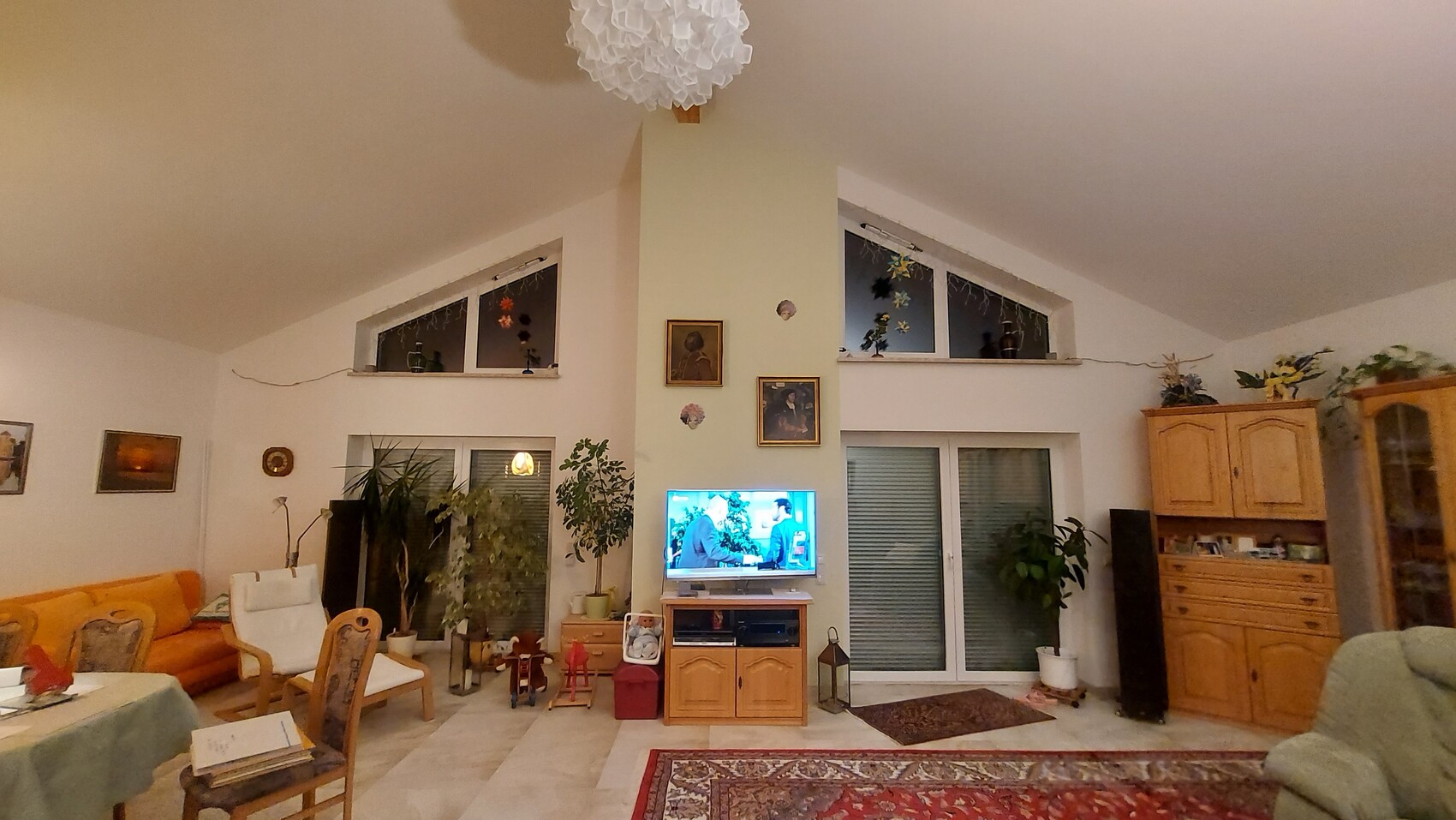

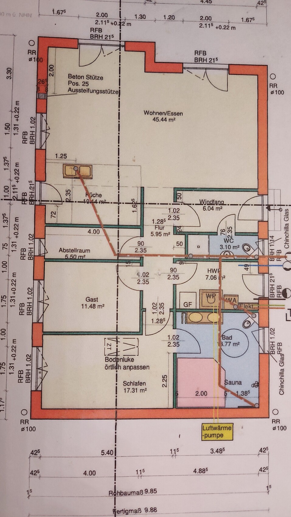

Who realistically looks out into the garden while watching TV in the evening?
Our TV is facing the garden, and it works great in the evenings. Our floor plan is optimal just for us.
The large open-plan living area faces directly south, and the terrace and garden serve as an extension of the living space.
Our children have already moved out.
Floor plan: Living/Dining, Kitchen, Hallway, Entrance area, WC, Bathroom, Sauna, Bedroom, Guest room, Storage room.
Living room with high ceiling, central column with pictures, TV on wooden cabinet, sofas, and plants.

I’m curious how you have arranged the sofa, glass wall, and TV.
