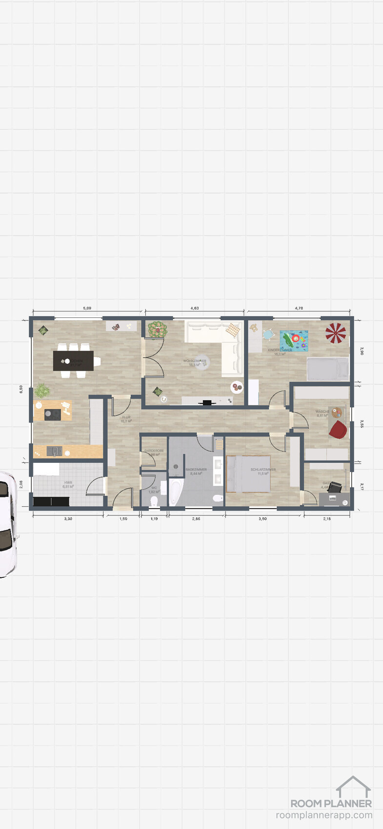

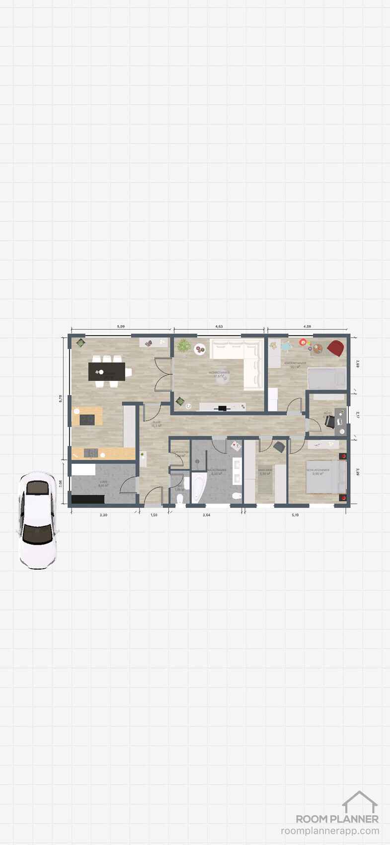

A widening to 10/11m (33/36 feet) relaxes the floor plan along the entire length.Do you mean a deepening?https://www.instagram.com/11antgmxde/
Z
Zweithaus16 Mar 2021 14:08Thank you all in advance for the kind responses. There isn’t much enthusiasm for the office, which is okay. However, the office in my old apartment was about the same size, and I felt quite comfortable there.
I plan to equip the wardrobe area only with a clothes rail. It would probably be possible to open the door into the hallway. I’m a bit of a neat freak and would prefer to keep my son’s mess and dirty shoes hidden behind a door. There’s also room there for his sports bag.
I would like the terrace to be located by the kitchen and the utility room. I might add a pergola there. I don’t like it when beautiful large windows are blocked from the outside by furniture. I’d rather look out onto the fields and enjoy the view.
By the way, I have only planned a “standard” window for the living room. I think it’s a bad idea to block floor-to-ceiling windows with furniture. Also, the living room is meant to be a cozy space, so it doesn’t need to be a glass palace. Who realistically looks out into the garden while watching TV in the evening?
motorradsilke16 Mar 2021 14:36Zweithaus schrieb:
Who realistically looks out at the garden while watching TV in the evening? Probably very few. But who only sits on the sofa in the evening? In the afternoon having coffee or on weekends (or during the week if you no longer have to work), lounging on the sofa, reading a book, browsing, playing, while occasionally glancing at the birds by the pond...
