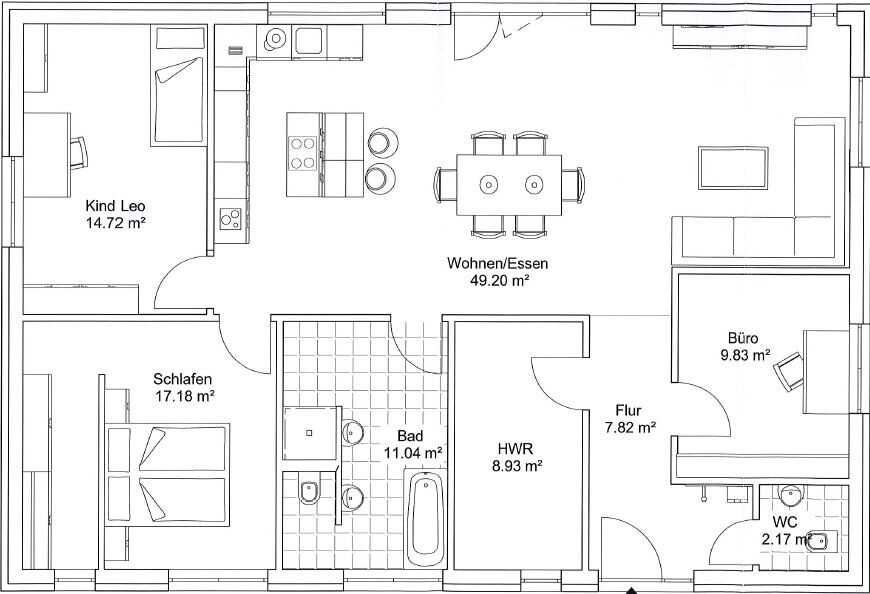

Architectural Style, Roof Type, Building Type: Modern, hip roof, bungalow
Basement, Floors: no basement, 1 floor
Number of Occupants, Age: 3, 41, 28, 0.5
Space Requirement on Ground Floor: approx. 120 m² (1292 sq ft)
Office: family use or home office? sewing, gaming
Overnight Guests per Year: none
Open or closed layout: open
Number of Dining Seats: 6 - 8
Fireplace: no
Music / stereo wall: no
Balcony, Roof Terrace: no
Garage, Carport: carport
Utility Garden, Greenhouse: no
Additional wishes / special features / daily routine, including reasons why certain things are preferred or avoided:
Simple, functional, modern
Who created the design:
Planner from a construction company based on our specifications
What stands out positively? Why?: large open dining/living area
What is disliked? Why?: I really don’t notice anything negative
Price Estimate according to architect/planner: approx. 200,000 € turnkey
Personal price limit for the house, including fittings: 250,000 €
Preferred heating technology: air source heat pump
If you have to compromise, which details / features
-can you do without: I don’t think much can be left out here
-can’t you do without: -
Why was the design created as it is now? The design is almost exactly what we planned. Only the room sizes and layout were adjusted.
What is the most important / basic question about the floor plan summarized in 130 characters?
I would simply like to know if at first or second glance the layout could be more functional. Thank you very much.

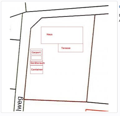

Now to the plot:
Lemming&F schrieb:
So, there is no site plan yet. The parcel subdivision is taking some time, and we are trying to complete everything possible in the meantime.
The only real limitation on the plot is its width of about 22 m (72 feet).
Two sides border a street/path. This path is only used to access other properties. Basically, only a cyclist passes by every other day. The other two sides border farmland.
Lemming&F schrieb:
The current plan’s access would be on the north side.
Sounds like a great location. However, missing a site plan does not give a free pass. Usually, you have to leave 5 meters (16 feet) of clearance in front of a carport if it’s adjacent to a street. You also need to be able to drive into a carport, and property access is usually only allowed from a specific side (the one with the house number). Even if your floor area ratio and plot ratio are listed as not applicable, you have to assume that especially in rural areas there are still limits on how much of the plot you can build on. Where I live, even a storage container would not be allowed just because of size… I won’t go into more detail here.
Lemming&F schrieb:
The carport could theoretically only be behind the house if you don’t want to shift the house too far.
No, theoretically it could also be placed on the east side as a boundary building.
Site plan of a plot with house, terrace, carport and storage room
Now look at your drawing: if the property is accessed from the north, how will you park your cars? That’s not well thought out.
And as someone pointed out earlier, this location sacrifices a sunny terrace.
Thinking further, you’re considering cladding a container in the garden.
How about simply reorienting the house and rotating it as an example? I see this is completely wrongly approached, yet you insist on it and accept or sugarcoat all the resulting negatives.

I would like to keep the layout without a hallway.
I would too!
LeosMama schrieb:
Definitely a must, because for us women minimalism only goes so far. The dressing room will be located in front of the sleeping area.
But you realize with these dimensions, even if rotated, it won’t be usable as a walk-in? Please draw in the bed and wardrobe.
LeosMama schrieb:
That means it’s not an ironing room (as was called somewhere) but an office—and it will actually be used as such, not just called one!
Your partner called it a gaming and sewing room.

Now something constructive:
It would be more relaxed if the kitchen were at the front (right side of the plan), and the seating area in front of the bedrooms. I admit I haven’t looked closely at the house plan.
But to start at the beginning, I would consider rotating the house and placing the carport on the north side. You can’t put it right in the corner but offset it a bit. This would create a southwest-facing garden including a terrace and even a nice seating corner.
It’s only a suggestion. Personally, I would prefer an L-shaped design. And if that doesn’t work, or you insist on sticking to this original situation now, then build the house that way. It’s your house and no one here wants to interfere with your life.

Once you have finalized the space for the carport, meaning you have found the optimal and permitted location, I would suggest making a rough sketch of where the rooms should be positioned and then planning again based on that.
Regarding my suggestion:
It would be more relaxing, for example, if the kitchen is at the front (on the right side of the plan), and the seating area is in front of the bedrooms. But I admit, I haven’t looked at the house plan recently.
Additionally, the bathroom door would be positioned further to the left on the plan – this creates a short path to the bathroom from both bedrooms, where someone standing by the stove or refrigerator would not have a direct view inside.

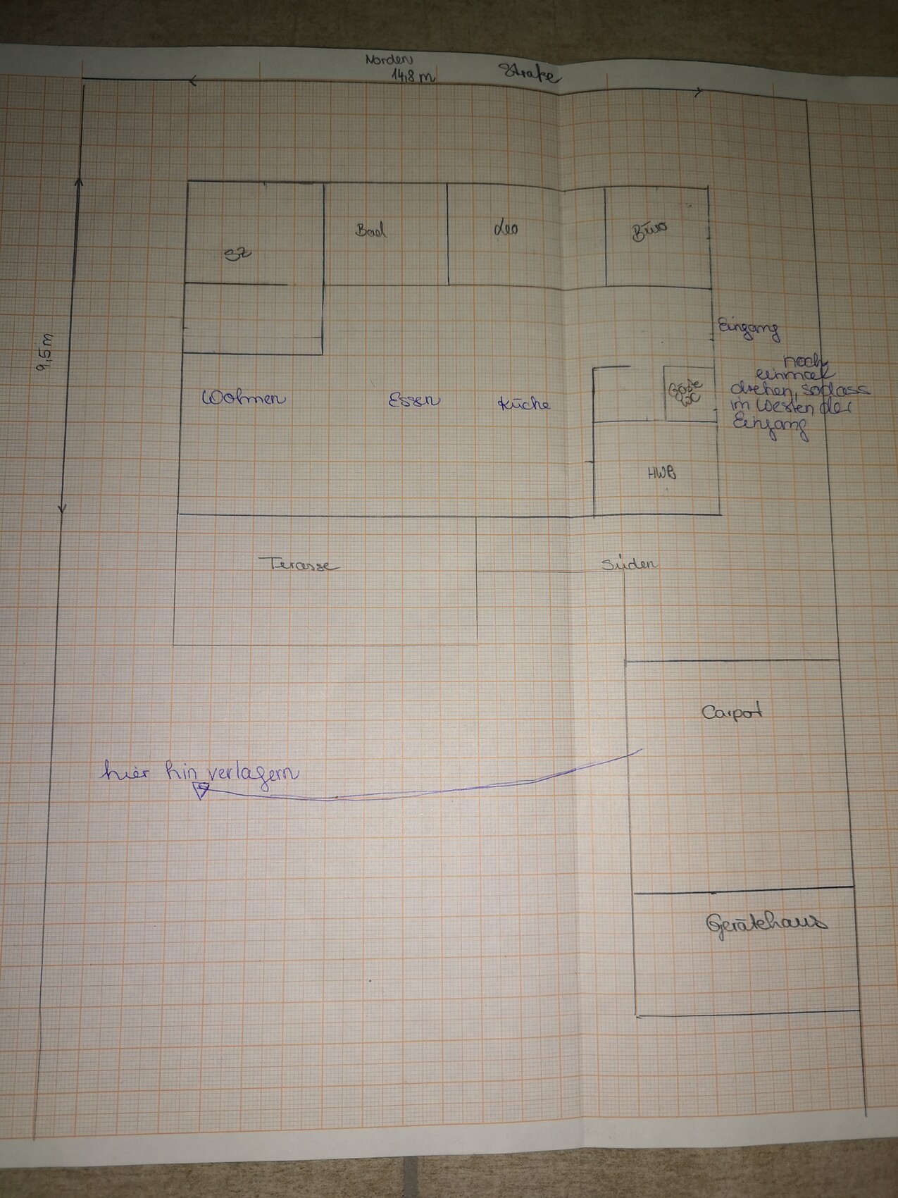

The comment about the lunch break was not meant to be provocative at all; it was just a greeting to explain why the reply is coming late. It was neither judgmental nor more than a simple hello.
The plot is not subject to any building regulation plan, so there is quite a bit of freedom in the design. If the plot were realized with a carport, the house layout would change accordingly. I will send a picture shortly. However, the house would then be mirrored with a new open floor plan, so the kitchen would be on the opposite side. My friend will prepare a proper and clear drawing tomorrow.
Regarding the walk-in closet: it would be walk-in and can be used without any issues.
As for deeper thinking – everyone has different ideas about that – about thinking and living. I personally fully understand what you are criticizing. However, the question is: where do I set the priority – having a separate corridor so that guests can use the bathroom unnoticed, or can I imagine that my guests will notice this since the loft character is preferred here. Ultimately, I really like the open-plan design.
The experience and suggestions are very important to us, which is why I also thanked everyone for them right at the beginning of my first post. Criticism is always welcome. Of course, there is a specific idea of the dream home (walk-in closet, spacious bathroom, open floor plan, office and guest toilet near the entrance, hidden wardrobe, no additional floors, loft style) which naturally limits and also needs to be taken into account in the overall concept. And then there is that annoying carport that somehow also has to fit in.
This exchange is very valuable to us, helping us to critically review and question things, but also to hold on to aspects we are comfortable with. I look forward to further discussions and am confident and aware that this forum will provide us with very helpful tips along the way.
PS: The picture is very unprofessional, but Leo is not letting me redraw it at the moment. The entrance would be on the west side.
