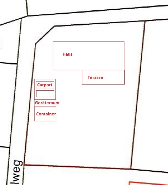

Lemming&F1 Apr 2019 16:24No, I would like to build a double carport with an adjacent storage room for the cars and garden tools. I could get a container like that cheaply, and it would serve as a workshop/storage space. There simply isn’t any more room inside the house for a workshop.
Of course, I don’t want to clutter up the garden, but the cars need to be parked somewhere, and the container is intended as a compromise to create a workshop space for me. If it is nicely clad or painted, it might not look like such an eyesore anymore.
