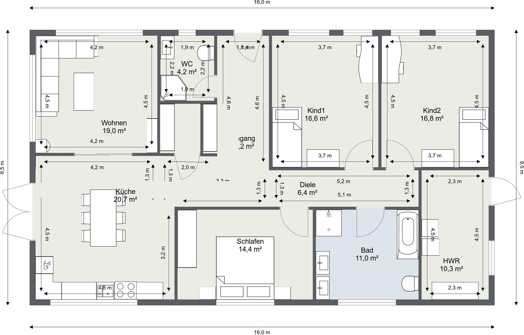

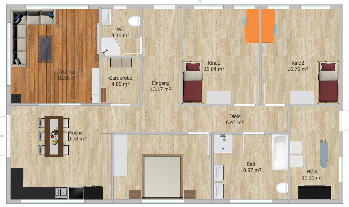

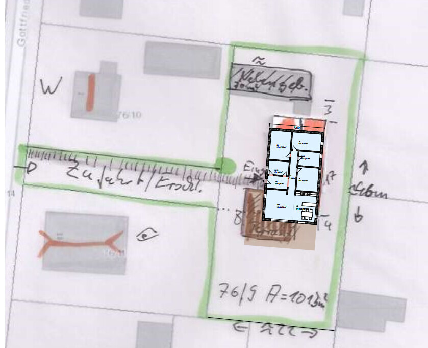

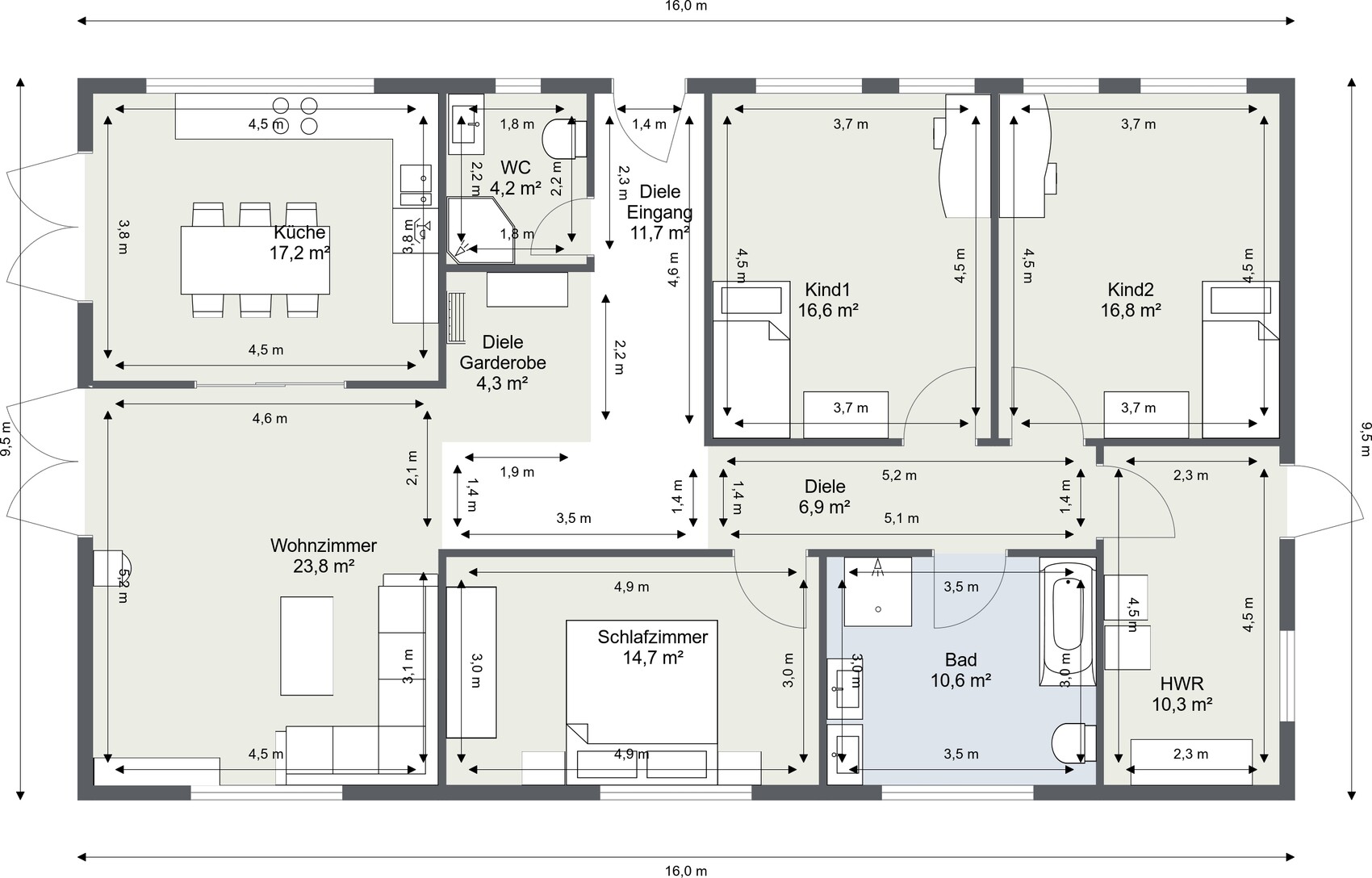

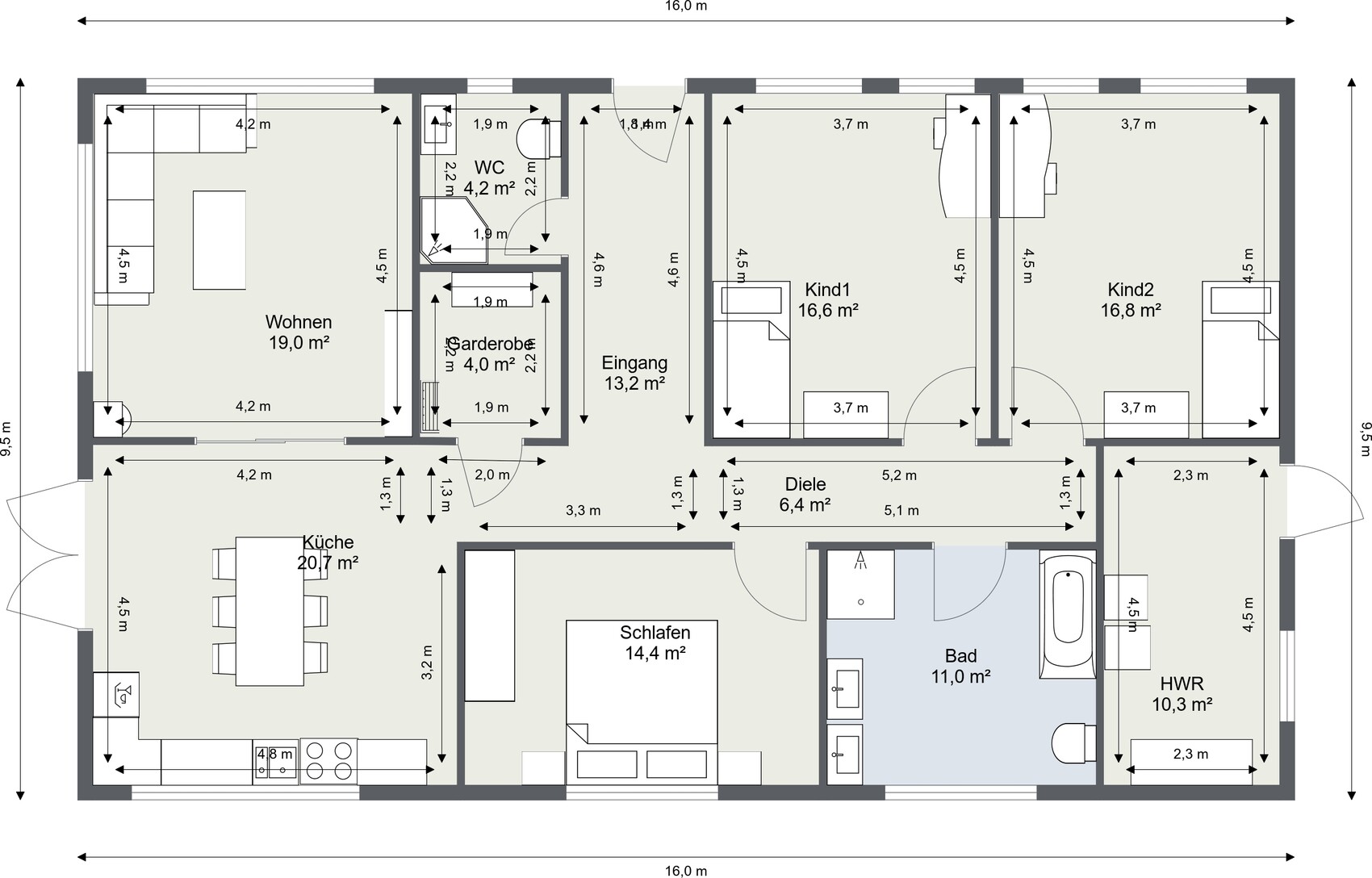

Hello forum community,

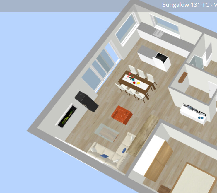

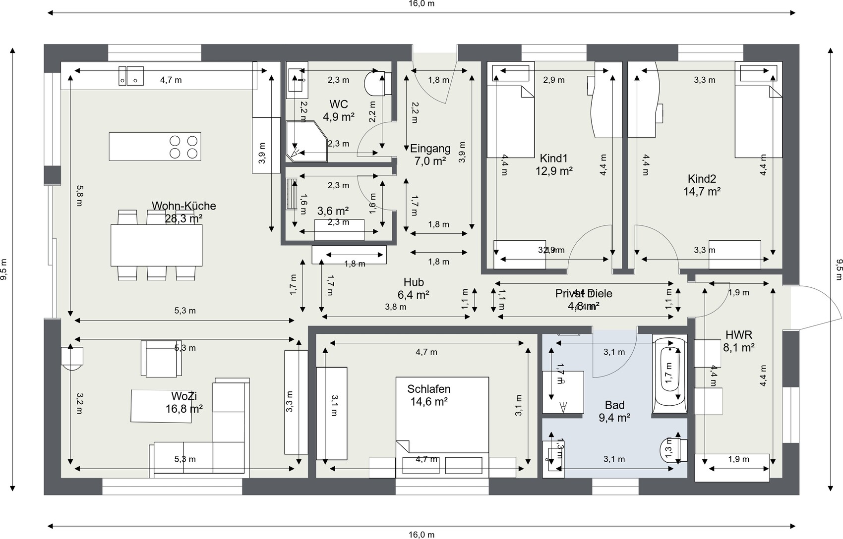

after gathering a few more ideas—and having received and tried to incorporate good feedback from previous posts—I would like to ask for your feedback on the current floor plan and your general opinion of the bungalow on our 1000m² (10,764 sq ft) plot with existing buildings.
The floor plan was created with RoomSketcher. I have tried to include quite a few pieces of furniture (kitchen is still missing) as references. The windows for the bedrooms and bathroom are not yet finalized, as I don’t have ideas for them yet.

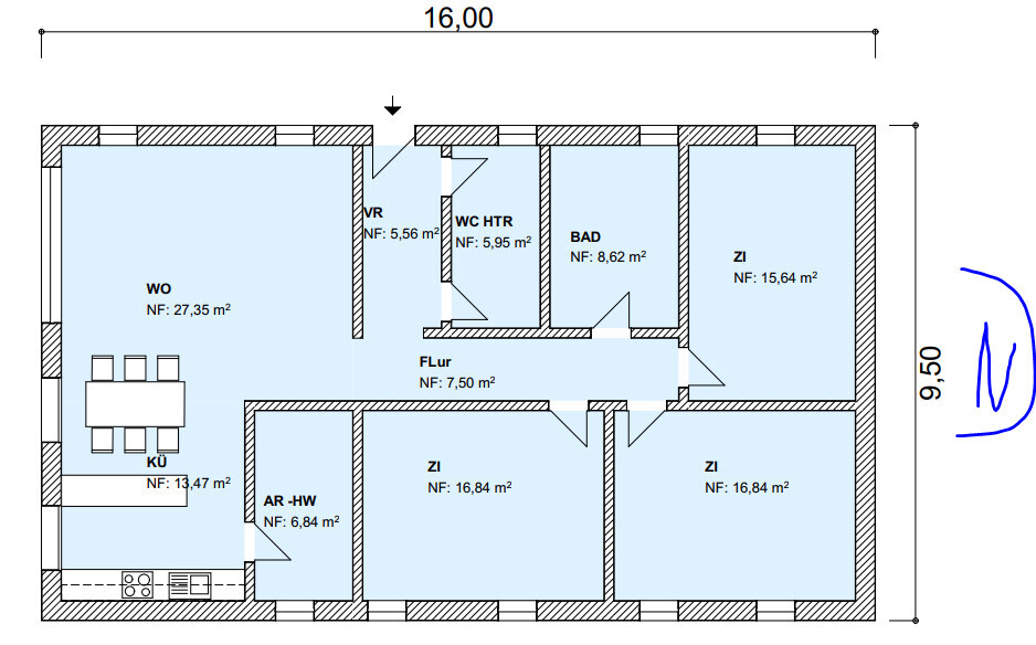

1.) Plot image + orientation
2.) Original building permit/planning permission (BU) after I designed/modified the draft

House dimensions: 15.87 m x 9.50 m (52.1 ft x 31.2 ft) (specified by BU to keep price close)

- Is the west orientation of the children’s rooms better than east orientation?
- Is the bedroom too narrow considering the ~2 x 2 m (6.6 x 6.6 ft) bed?
- Should the kitchen have its own small dining area?
- Size and number of windows for the living room with southeast orientation
- How should the living room furniture be arranged?
- Should the living and dining rooms be swapped? (SE <-> SW orientation)
--> Dining room faces southwest to see who is arriving
- Is it better to have one floor-to-ceiling window (which size?) or two windows in the children’s rooms?

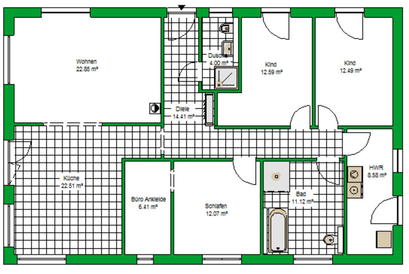

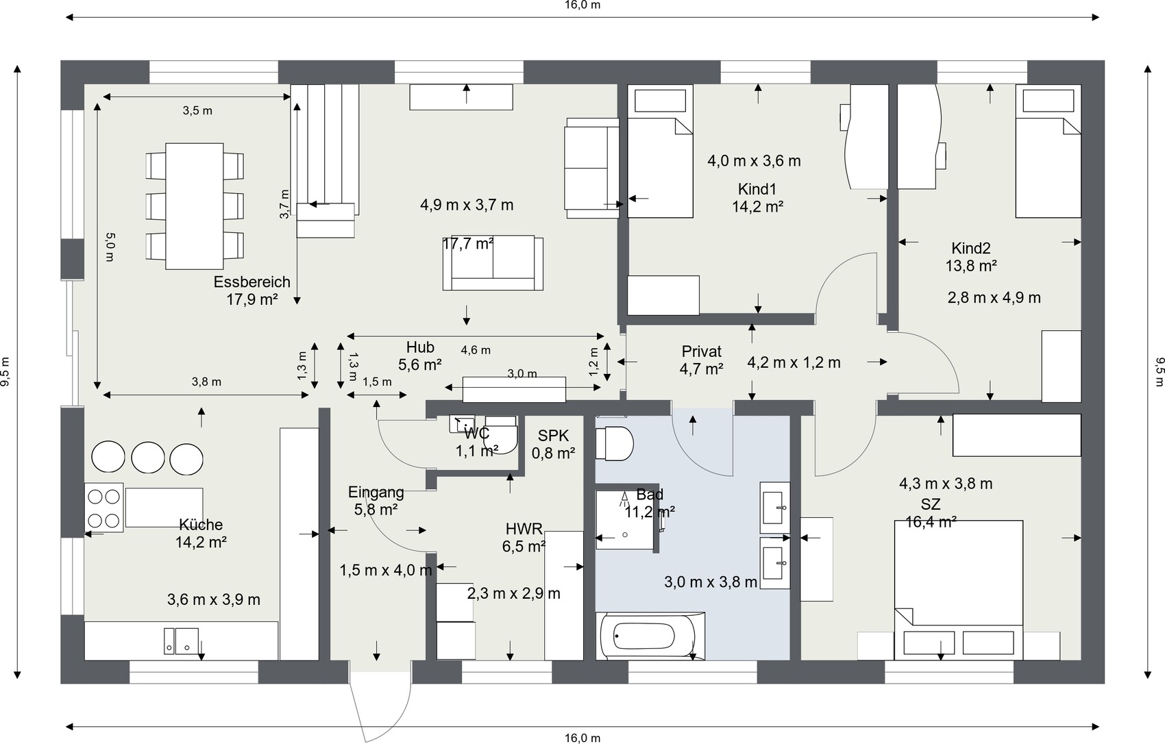

Whatever the sixth option out of the four variants is supposed to be – did you ever mention before that a new driveway is to be built from the west (I had assumed until now it would go from the north past the shed)?
No. There will be no new driveway, and as you correctly understood, the path must go around the house. This would be accepted for a "perceived better orientation" of the rooms. I am aware that this involves additional costs. However, guests can be received via the access path from the west side or via the terrace.
Congratulations on the complete confusion, I’m out of here then.
micric3 schrieb:
No. There will be no new driveway, and as you correctly understood, the path must go around the house. This would be accepted for a "subjectively better orientation" of the rooms. What?
So far, I find the entire project completely chaotic, ill-considered, and all the floor plans ugly and unsuitable. Sorry, I’m telling you this honestly as a friend who wants to help. It looks to me like a temporary shelter rather than a dream home. On top of that, important information about paths and utility connections is coming through only bit by bit, and in the end, I no longer know where the garden gate for the mail carrier is supposed to be or where the cars will be parked.
I think it would be very important for you to hire a proper architect (not friends who draw as a hobby). You definitely shouldn’t bring your own drafts—ideally, just provide the number of rooms. Then have the architect prepare a design and come back with the results. I believe every dollar you invest in a professional will be well worth it.
