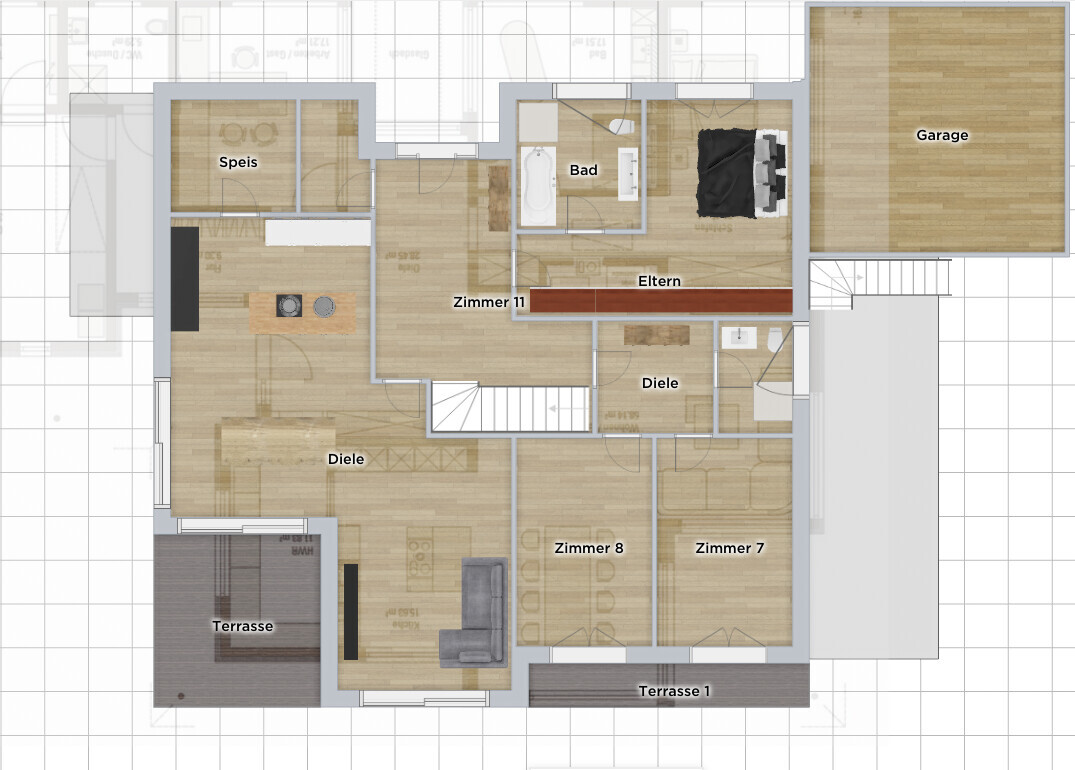

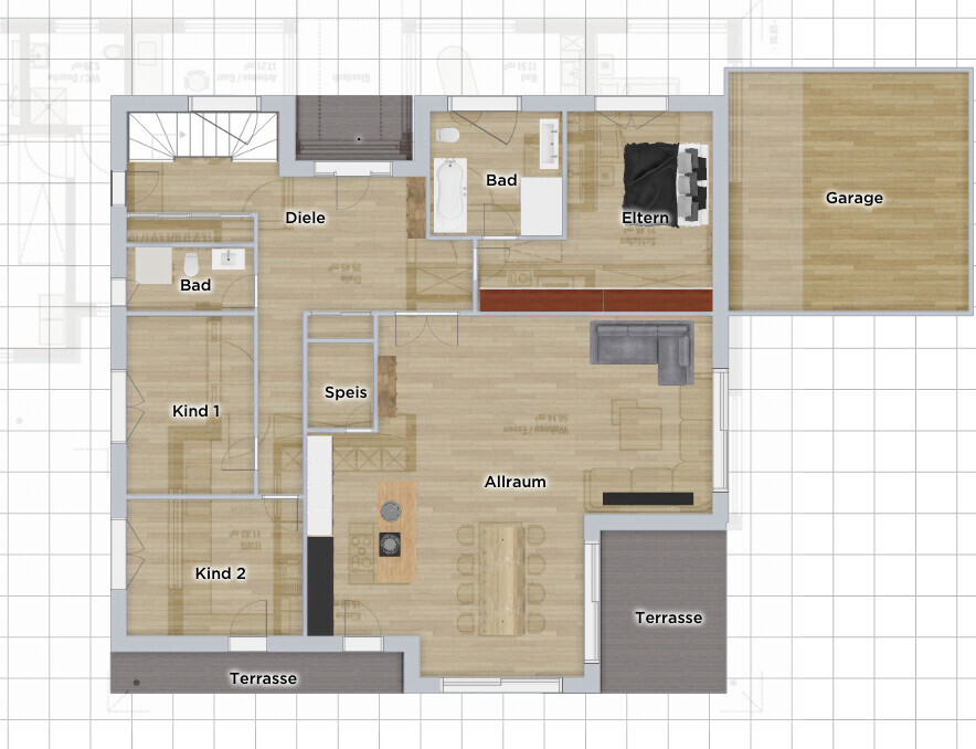

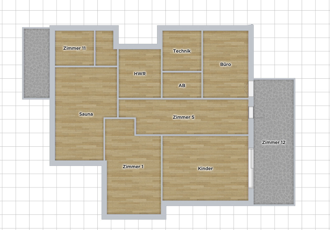

I had mentioned an idea "a la Vita, Weiss" and also put it into practice:
Of course, I kept the desired basement in mind... but I have to say, it is quite difficult to create a ground floor, that is, a bungalow with such a large area in the "center" of a house that uses so much space, without ending up with very long corridors or dark recesses. The basement is unsatisfactory overall. The rooms are dark inside, even though there is a light well built there and a panoramic window. Creating an apartment there would be a real challenge, and only possible with closed eyes.
Anyway: I managed to achieve something in principle. Everything fits within the 15-meter side length. I haven’t focused so much on the floor area... and also the light wells and the basement terrace mentioned by the original poster no longer fit with the floor area ratio. The house feels like it takes up almost the entire plot: 3.7 or 6 meters (12 ft or 20 ft) in front and on the sides (a light well also requires a setback from the boundary) means there’s hardly any garden left.
I’ll spare the details here – the forum members are aware of such issues – ultimately, the original poster has to decide how to position the house on their plot.
Logically, I moved the terrace to the southeast. Since it is covered, it is at least protected from the wind there; a southwest terrace would be windy and the roof would not help. I also wanted to do the children a favor with the west side 🙂
But basically, the designs could be adjusted; the garage could also be shifted from west to east.
Much depends on everything else, so moving this and that usually affects other elements and things don’t work optimally anymore.
As I understood it, the children do not need their own bathroom?
Here are the designs. Please note: interior walls currently measure a rough 10 cm (4 inches), and the exterior walls 38 cm (15 inches). The kitchen island is 2.40 m (7 ft 10 in) long, the bedroom windows 1.80 m (5 ft 11 in) wide, and the panoramic windows measure 3 meters (10 ft).
Up is naturally north 😉
I’m still here for any questions 🙂

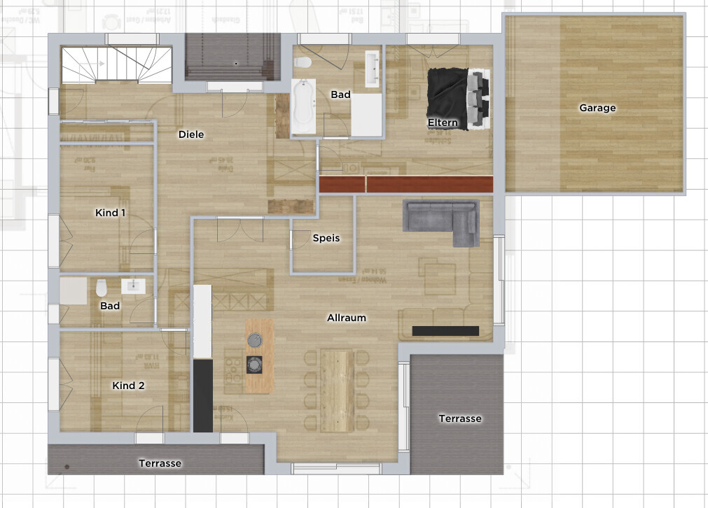

Myrna_Loy19 Apr 2021 12:41Definitely better, and the separation is done in a stylish way. But it still meanders way too much for me. It looks like the floor plan of the Palace of Knossos again. 🙂 Or those labyrinth games with the small metal ball.
[ATTACH alt="Screenshot 2021-04-19 at 09.33.25.png"]60350[/ATTACH]I have to say, this one appeals to me the most (but of course, you can also work your magic!). I also really like the bungalow concept (all rooms side by side). I appreciate that I wouldn’t have to walk through the entire house to get to the kids’ rooms.
I might consider removing the wall/door to the hallway to allow some light to come through.
