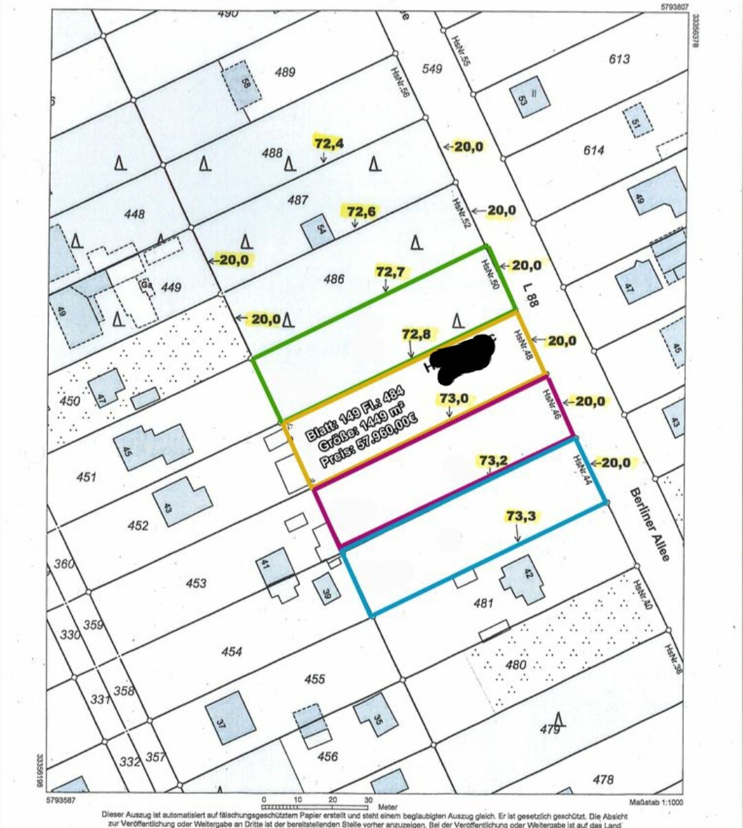

Ybias78
23 Jul 2020 19:57
What’s this supposed to be?
A site plan includes the neighborhood, vegetation, streets, and things like that.
It’s a bit tiring... you hardly contribute anything except suggesting "to play Tetris" – especially when the person can’t even follow these few simple lines
https://www.hausbau-forum.de/threads/grundrissplanung-unbedingt-vor-beitrag-erstellung-lesen.11714/
The only thing I can offer you is this. The site plan is still in progress. Our property is marked in yellow. The street side is north.
Cadastral map: Parcels outlined in different colors (green, yellow, pink, blue) with numbers.
11ant23 Jul 2020 19:58
Ybias78 schrieb:
The top is south,
Sigh!
A site plan includes the neighborhood, vegetation, roads, and that sort of stuff.
I think my house will be finished before this understanding becomes standard :-(
