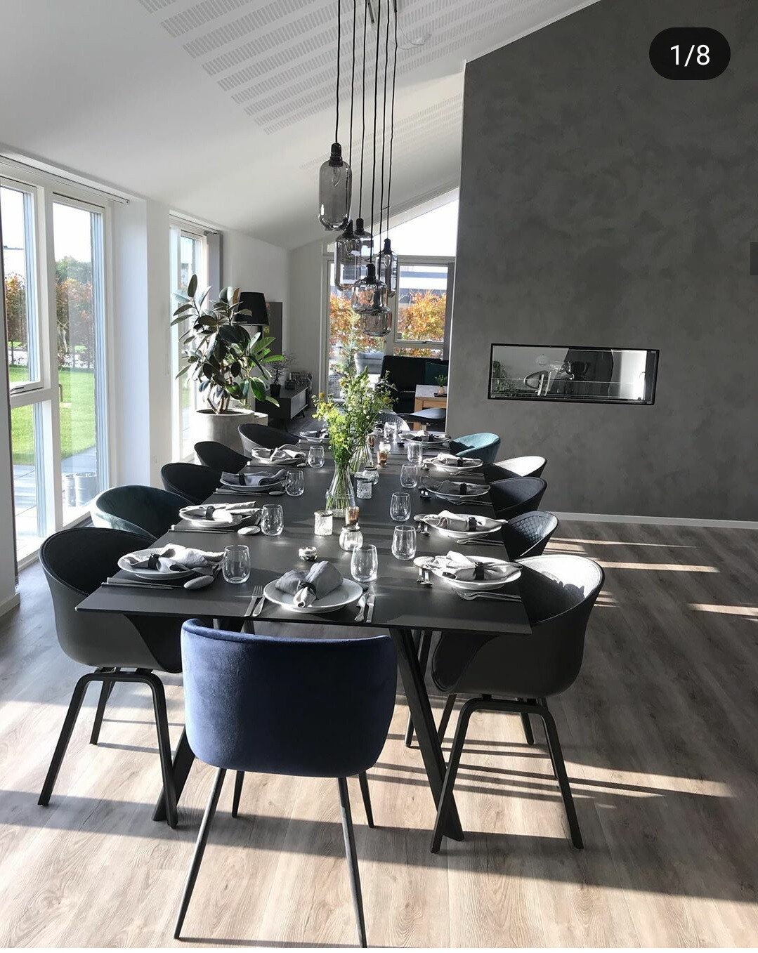

In fact, with this builder, a bungalow is cheaper than a 1.5-story house, since they build bungalows about 80% of the time. In the basic configuration, it's roughly 25,000 euros less. The whole issue of quality of life is, of course, also a matter of perspective. No stairs to climb in old age, no sloping ceilings (which I currently have and find annoying), and the actually possible high ceiling with the skylight in the living-dining area as well as tall windows in the gable simply enhance the room. I didn’t believe that before either.
